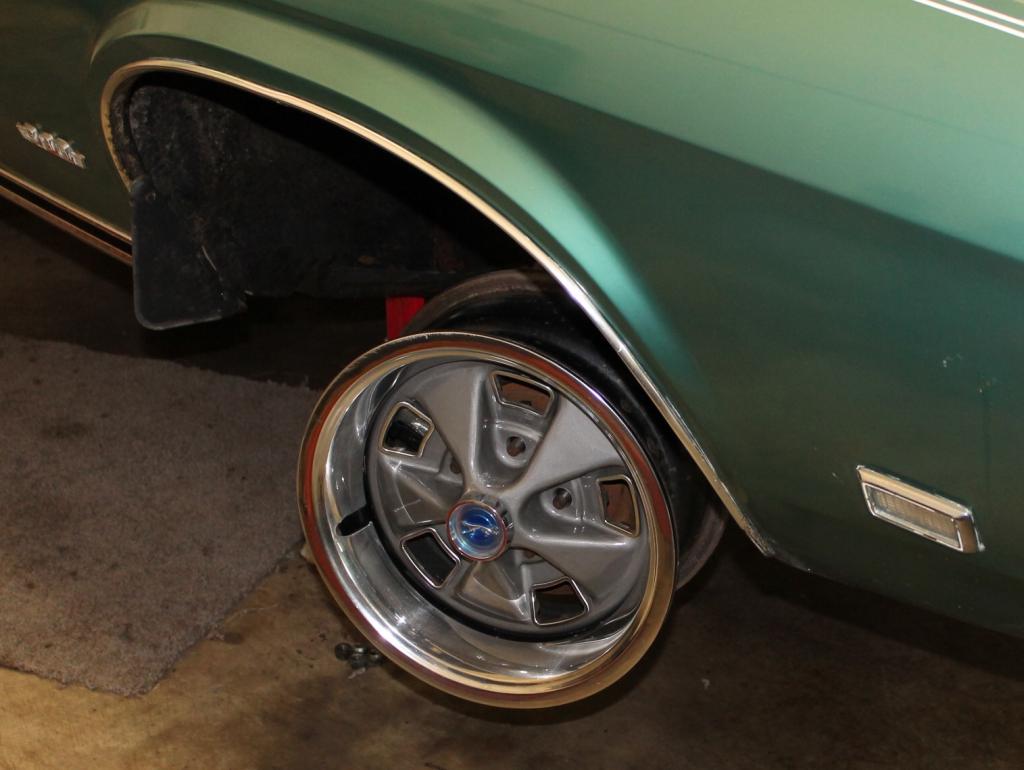

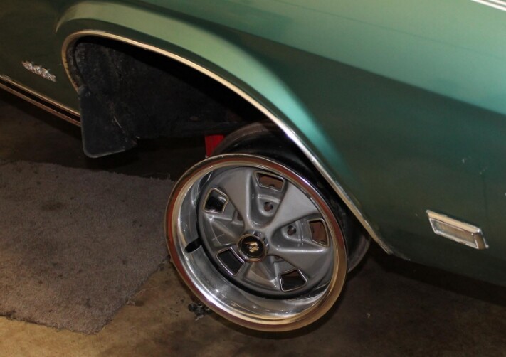

OK, good news bad news. The 9426 Dupont number only comes in a vinyl spray, but that number crossed over to 31516A enamel only it is gloss. So, I got a pint and added 25% flatter to take some gloss away. It mixed up way to light, so I got some black tint to see what I could do with it. My first spray after adding some tint was way to light. I went real heavy with the tint on the second spray about a 1/4 pint using all I had. Still not dark enough and not a match to dark argent. Don’t go this route for dark argent. I think I would go with a quart from Eastwood doing it over again. OK that is the bad news.
Good news is I really! like the color I ended up with against the med green poly paint on the Cougar. It’s only paint and wouldn’t be that big of a deal to change later to stock if I decided too. Here are a couple of pic’s of the wheel and trying to decide what center cap would look good. Also considering the repo black center cap with the running Cougar.
