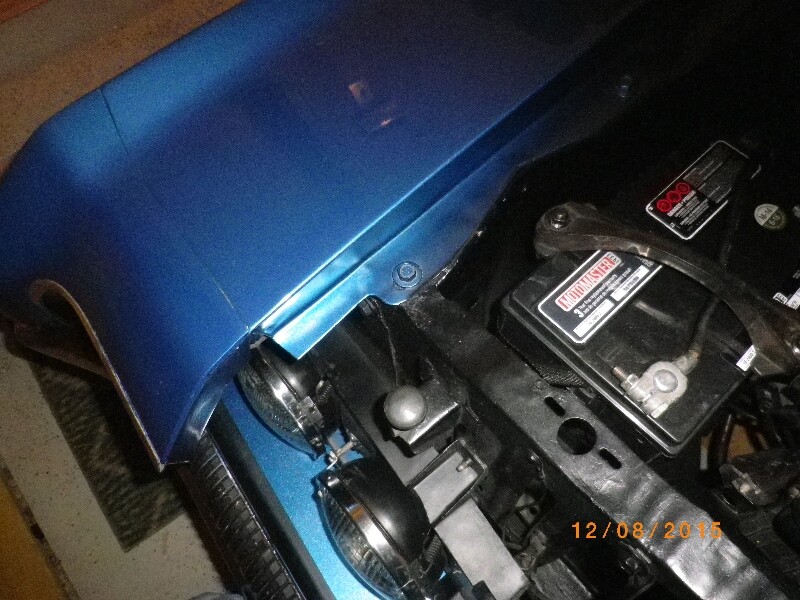

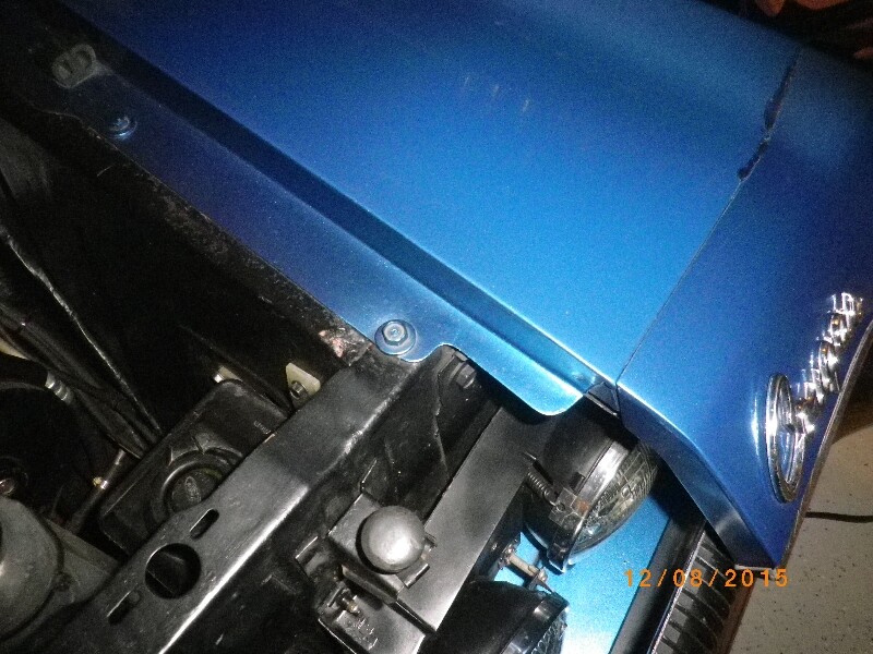

Here are pics from my 1970 Vert. New fenders installed around 1995. I would be really surprised if same “mistake” would have occurred.

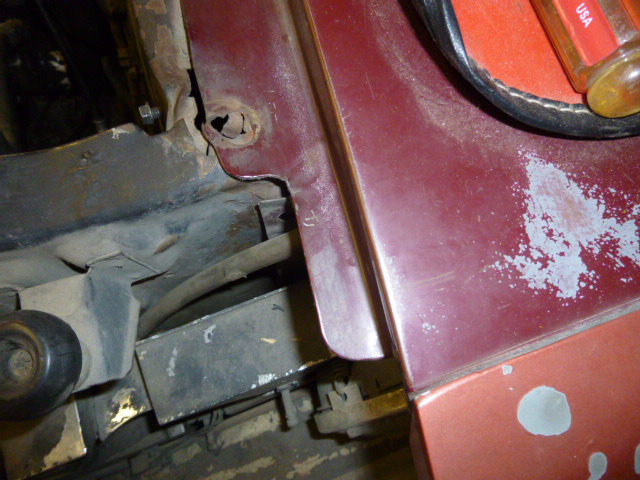

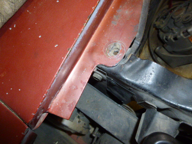

My 69 is the same way, squared off on the passenger side and rounded on the drivers.
Me three.
