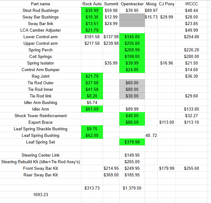

I know my spreadsheet is lacking part numbers, but just assume I’ve tried my best to pick “good but not outrageous” parts as much as possible. Does it look like I’m missing anything important? Can I reuse the original spring shackles? Do I need U-Bolds, or isolator pads or whatever?
Do I have stuff on my shopping list that I don’t really need to worry about? I was thinking I’d put a bigger sway bar under and add a rear sway bar while I’m in there, but on second thought let’s just do the mostly stock stuff and the stuff that will affect the alignment first. Can always come back for mods later as not many new parts would end up getting replaced anyway.
