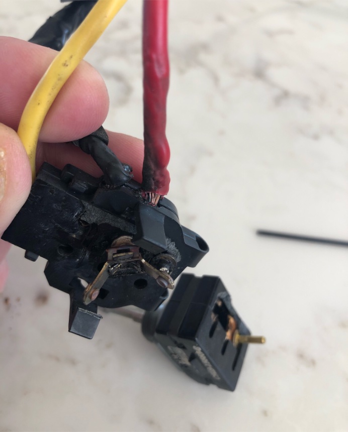

Some more context on the “TOP” switch. Here is the switch with melting on the attached wire (continuation of wire from starter solenoid ), this was behind the dash, thankfully the wire under the hood failed first.
Then the switch melting, it had melted together enough that it would not pry open as intended. The total time power was being pulled with no response/sound from the motor was under 5 seconds. There was nothing binding the top to force the overheating, the switch just failed. Thats why I would buy a new reproduction over a +50 year piece of plastic with no use history.

Awesome - nice to hear a success story! Totally agree on new switch. Those switches switch both power and ground in order to reverse the motor, so it’s quite possible for them to short to ground like yours did. I need to get mine replaced soon as well
