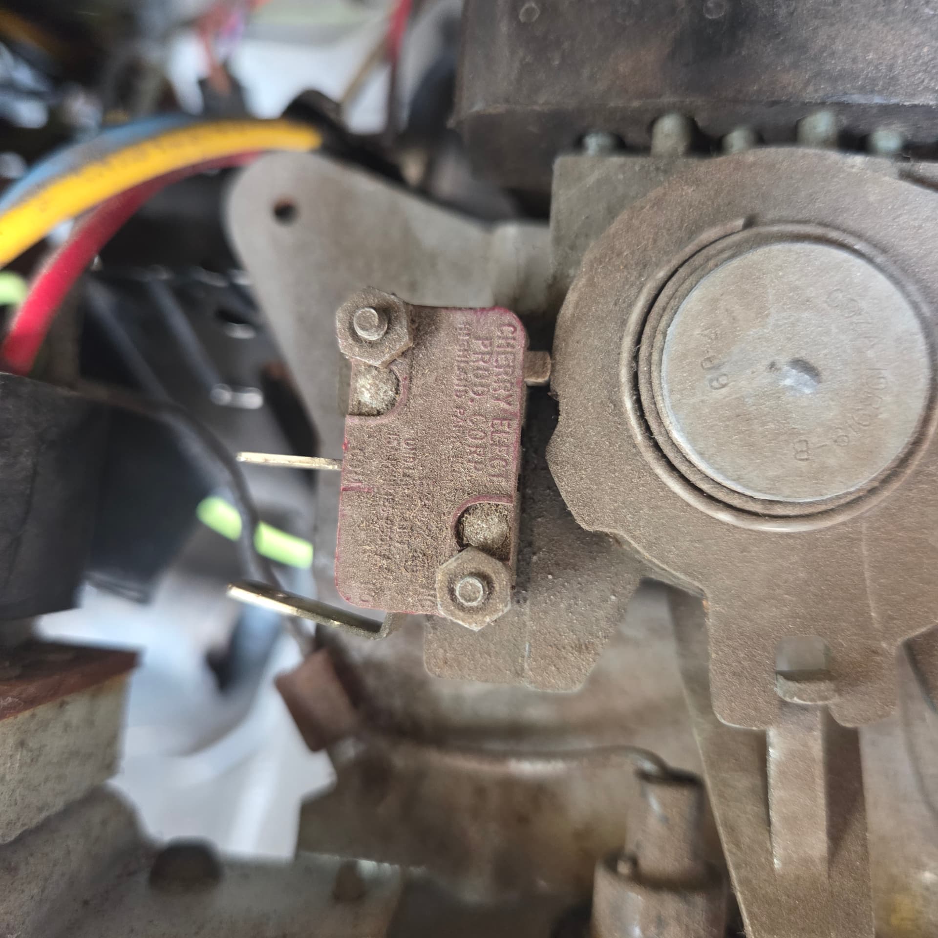

Can someone help a guy out with what connwctors goes on the microswitch on the ac/temp control as seen in the pic?

That is your AC compressor switch. Should be a green wire piggybacked from the blower switch connector to one terminal (doesn’t matter which one), and then the other terminal plugs to a green wire that routes through the evaporator coil icing switch before going through the firewall to the compressor clutch.
Thanks. I know the 2 you are talking about. Couldn’t remember where they went though.

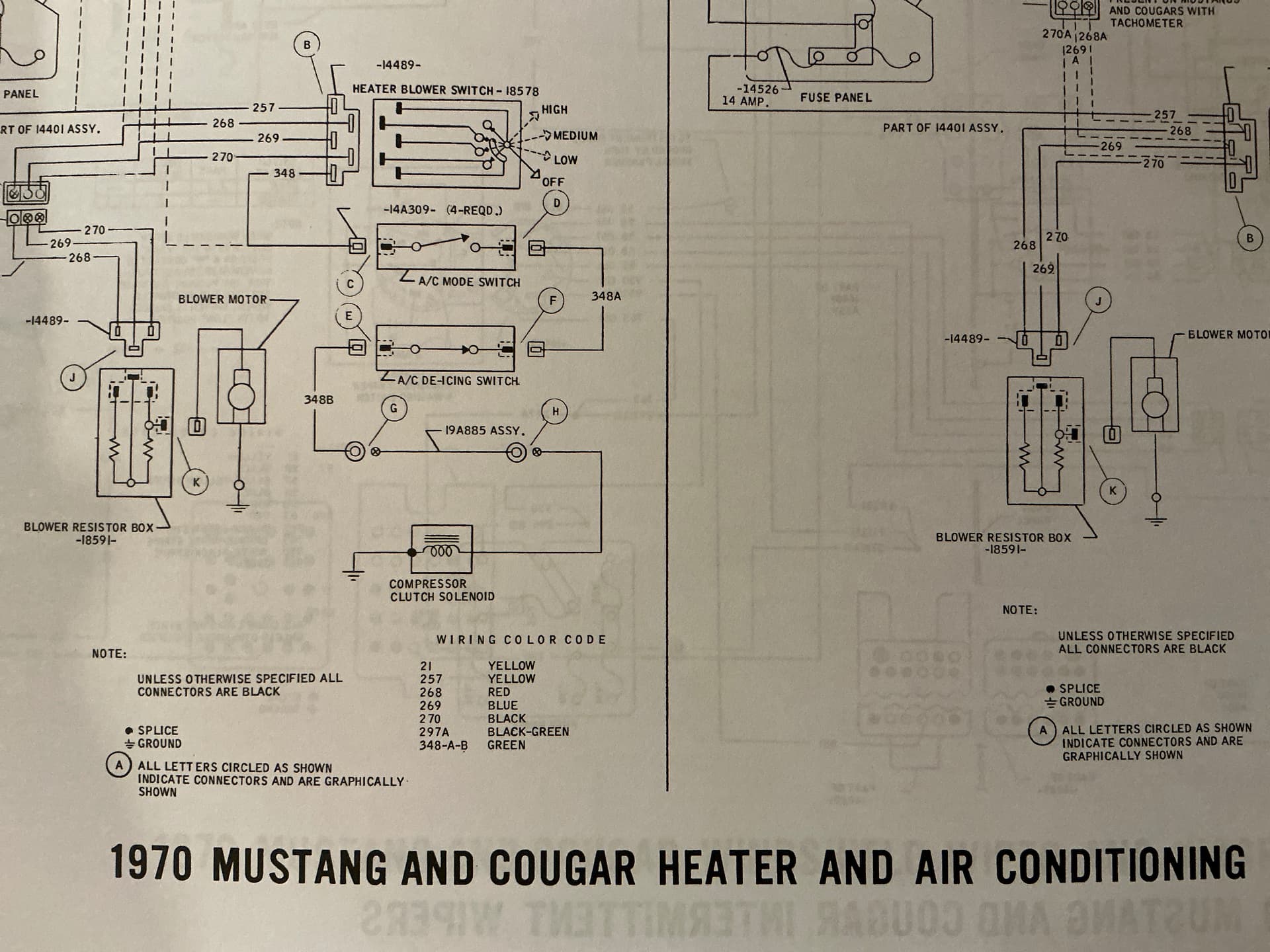

The two green wires go to the icing switch then to the compressor switch. The icing switch is a high failure item mounted to the AC box with a temperature probe inserted in the AC evaporator.
12V power on its way to the compressor actually comes from the blower switch, then through the pictured mode switch, and then through the icing switch on the AC box before going through the firewall to the compressor.
