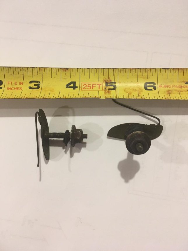

Having a hard time with my longer fastener clip out of the three don’t know if I have the right one anyone have a picture or a good description of the one I should have thanks much
69 and 70 eyebrow mouldings are a different size at their bottom end therefore the attaching clips are different sizes. A 69 will use 2 short and 1 long clip. A 70 uses 3 short clips.
