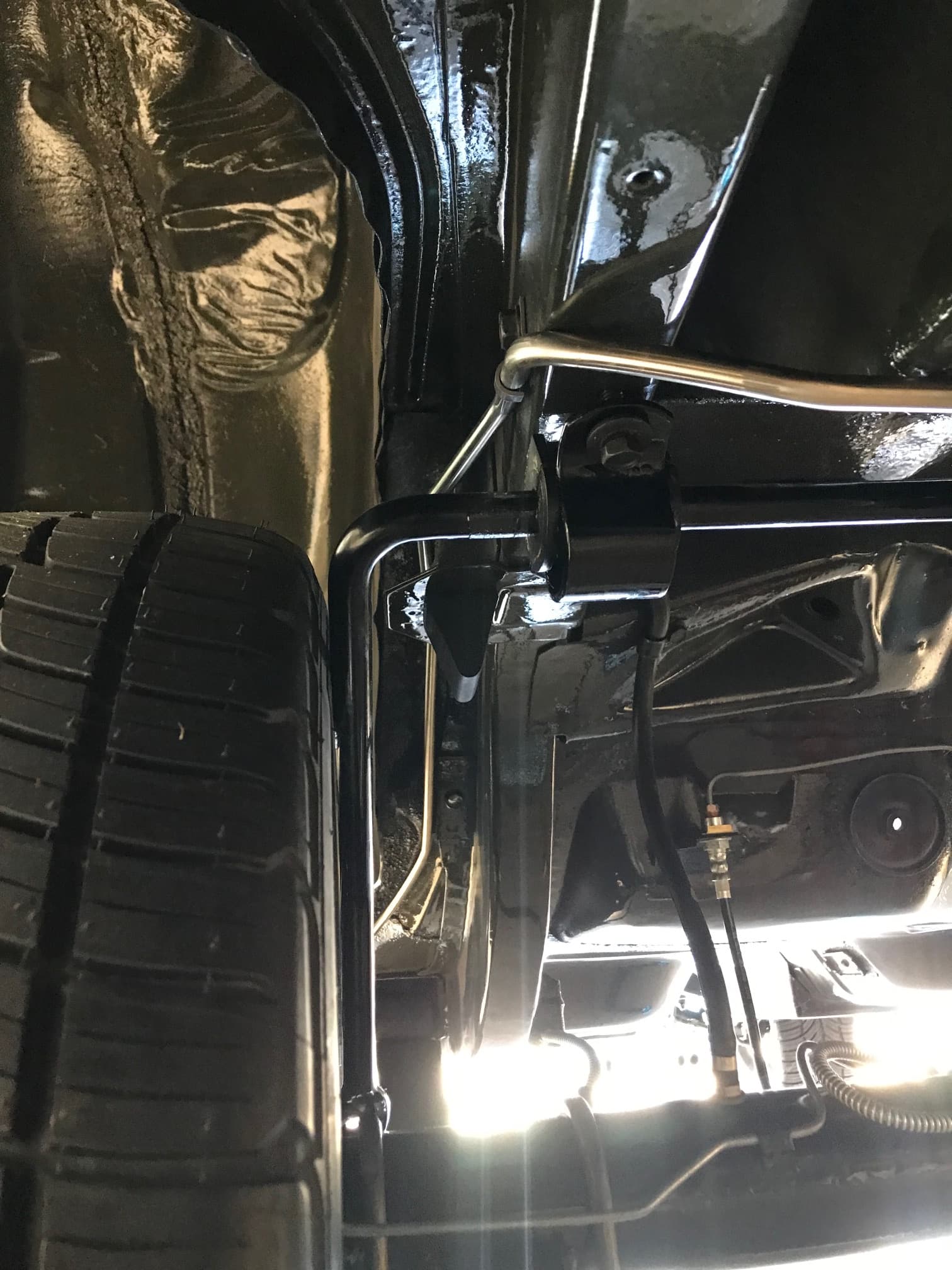

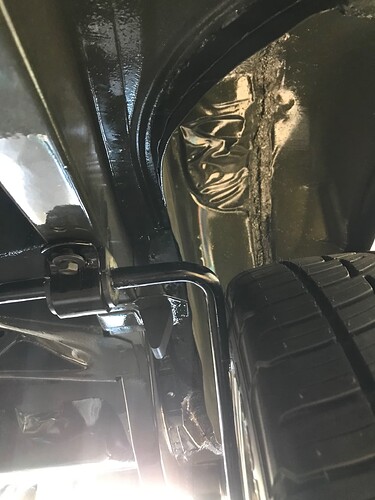

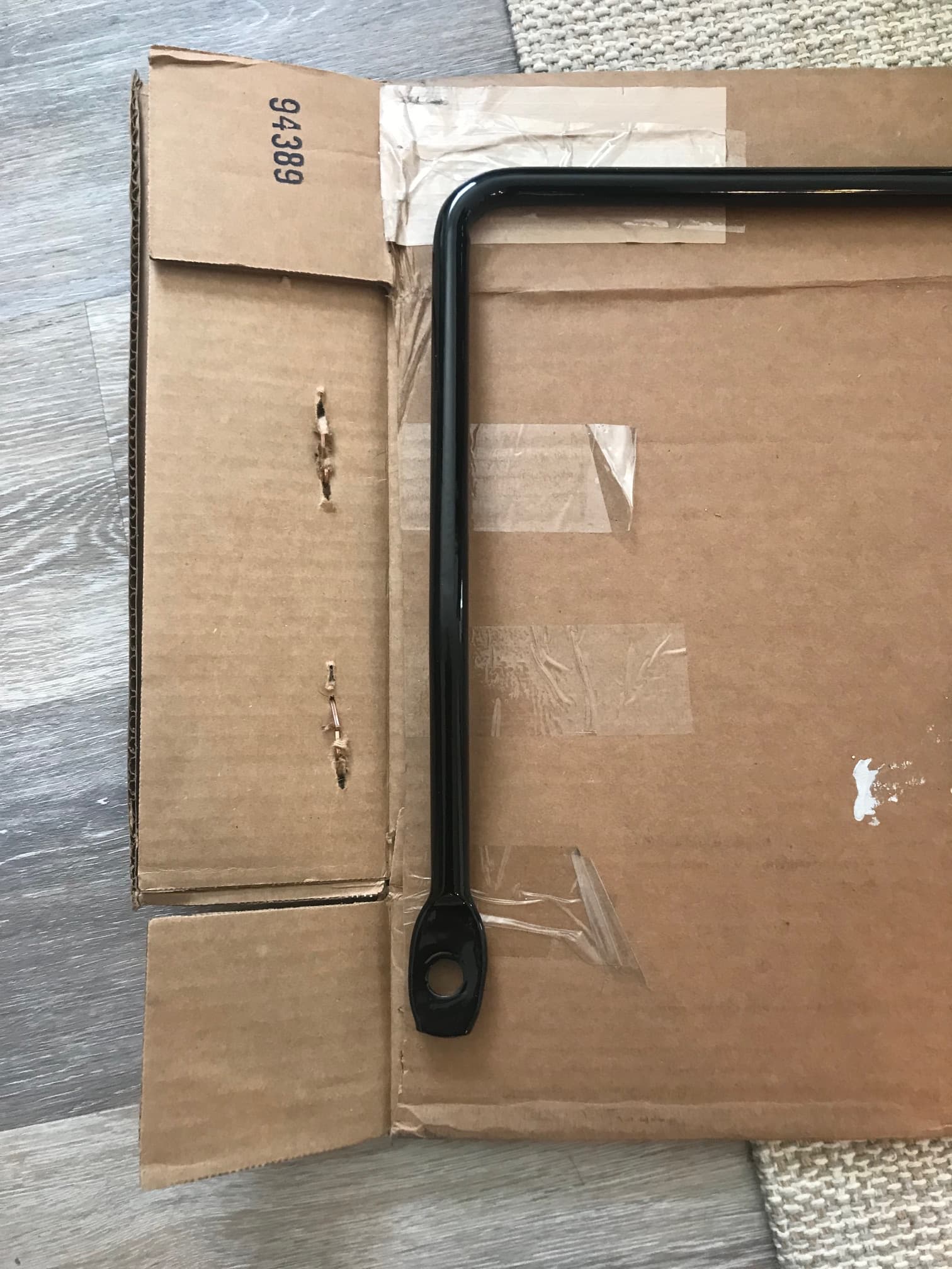

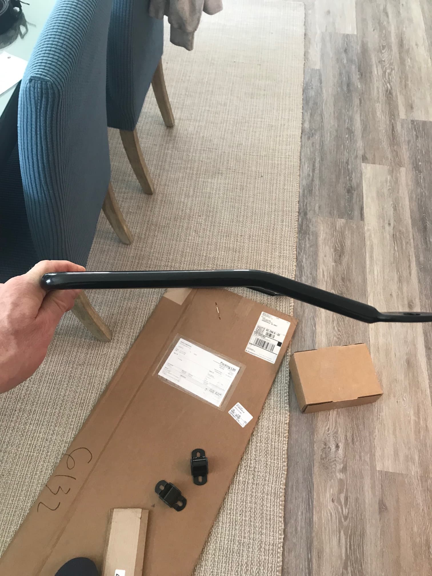

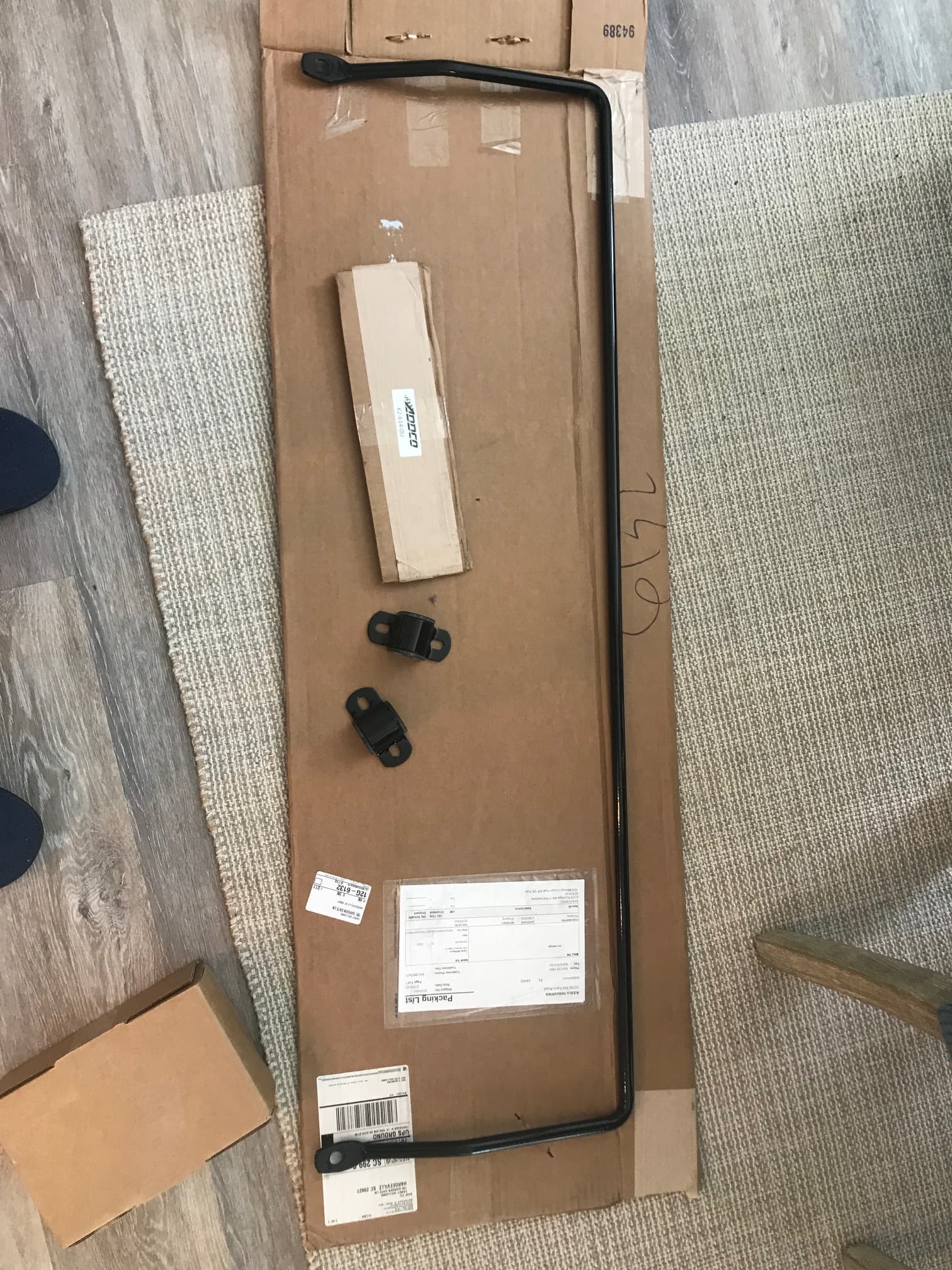

I got the new Addco bar. Basically same shape as a stock bar. The eyelet is different as mentioned above. Gloss black powdercoat bar and brackets. Does bolt to stock location. Very nice looking bar.

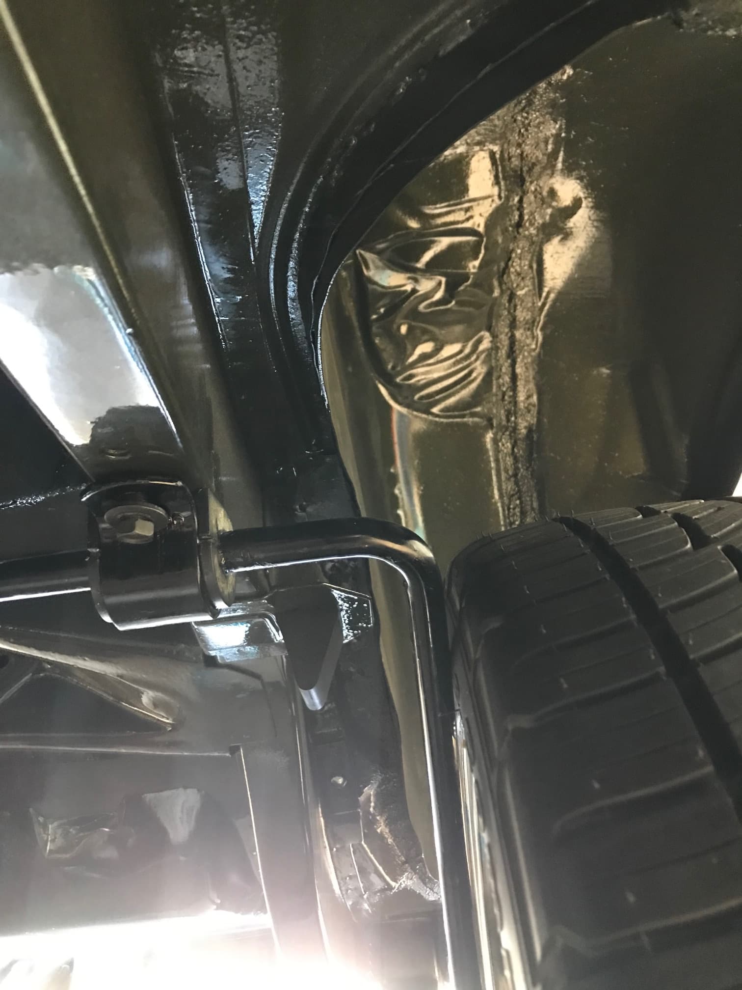

Now, Being a stock shaped bar I believe it will not fit with any wheel wider than 4.5" of back space to be safe. I have 18x10 with 6" backspace and the bar hit the tires on each side. Tires are 285/40/18 tires. I need a bar shaped like what the last picture is. I’m going to ask Ernie to make this bar for me. There are other options that bolt to the rear housing but do not like the look.

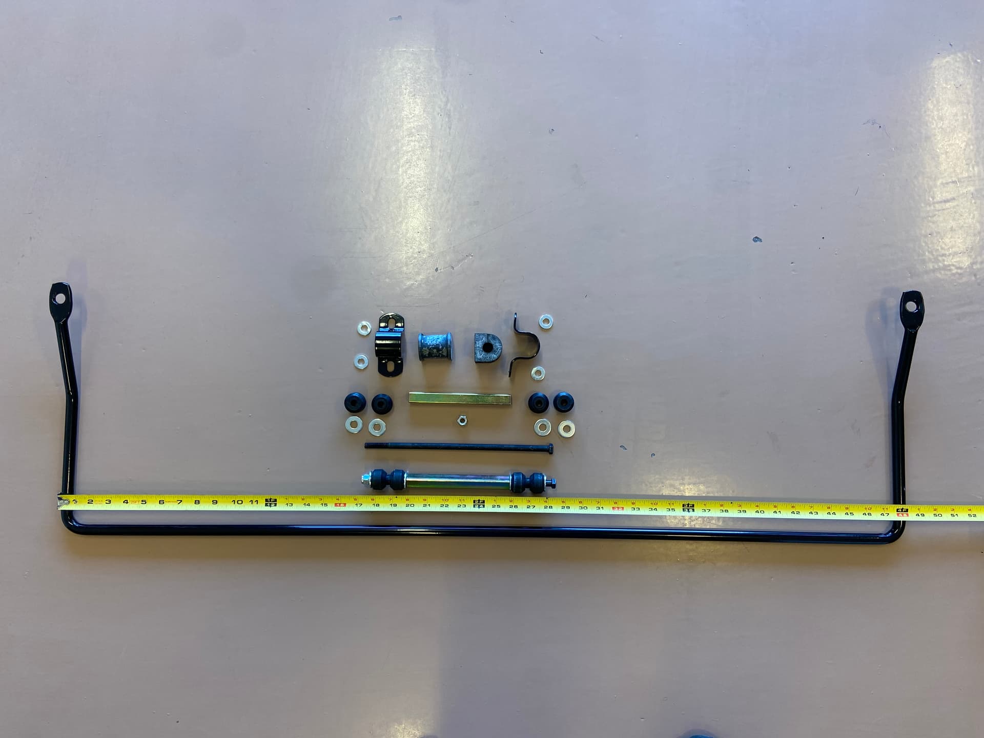

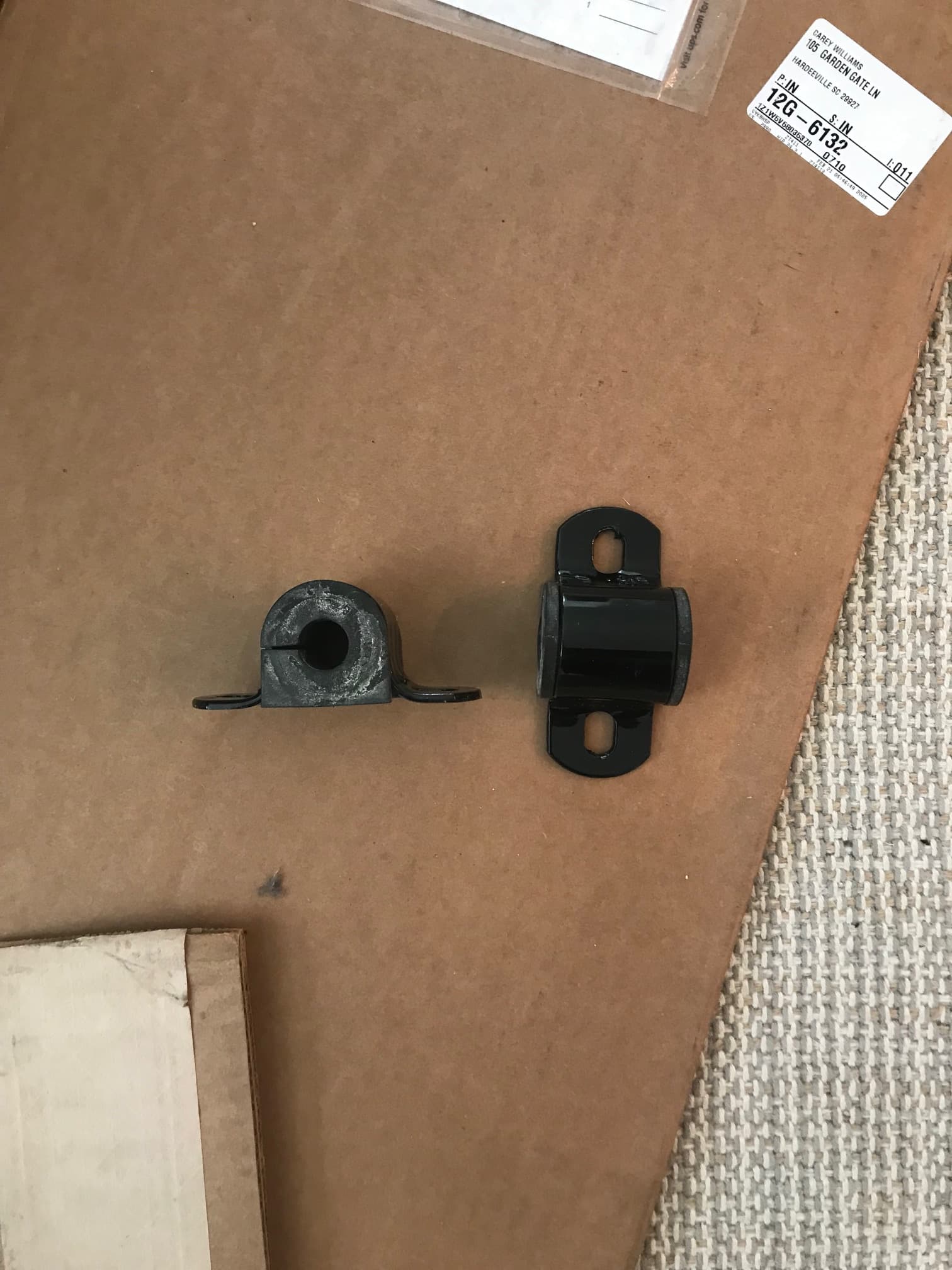

Just got chance to post some picture of the same Bar. Did you use the ADDCO hardware Kit for install?

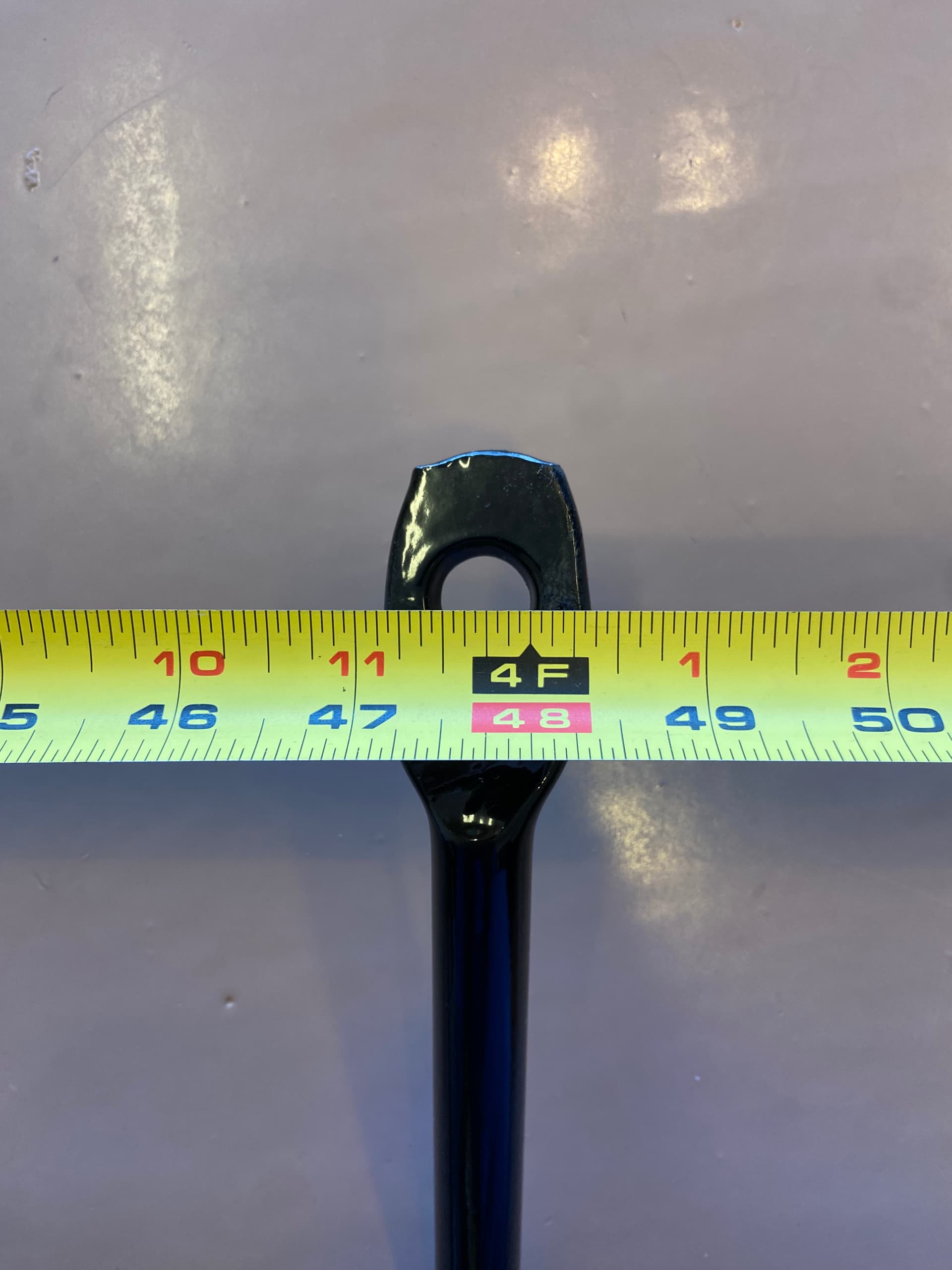

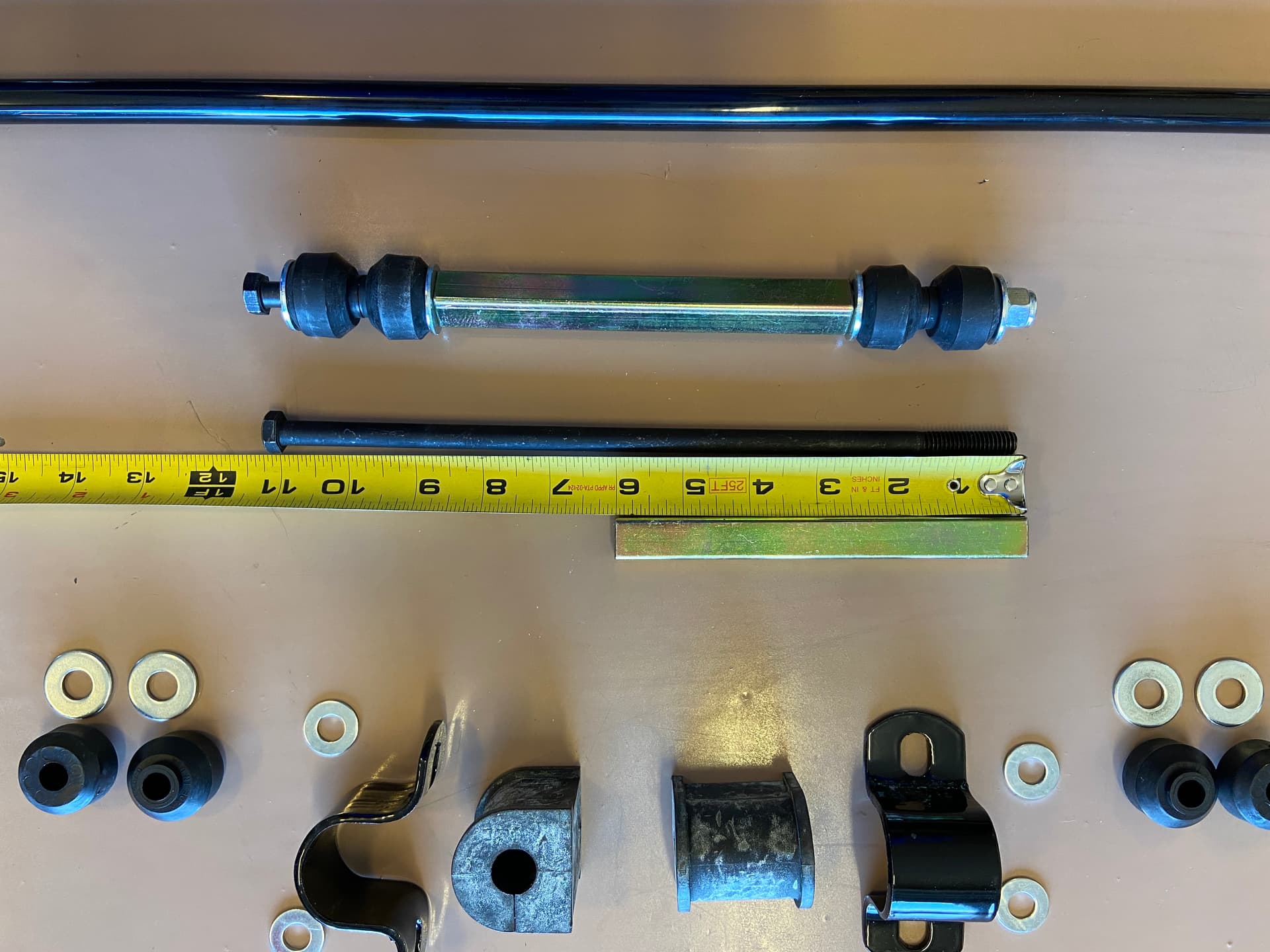

This is the ADDCO 1970 Cougar OE Style 5/8” Rear Sway Bar (P/N 02-614-00) and Hardware Kit (P/N HW2-2614-0U)

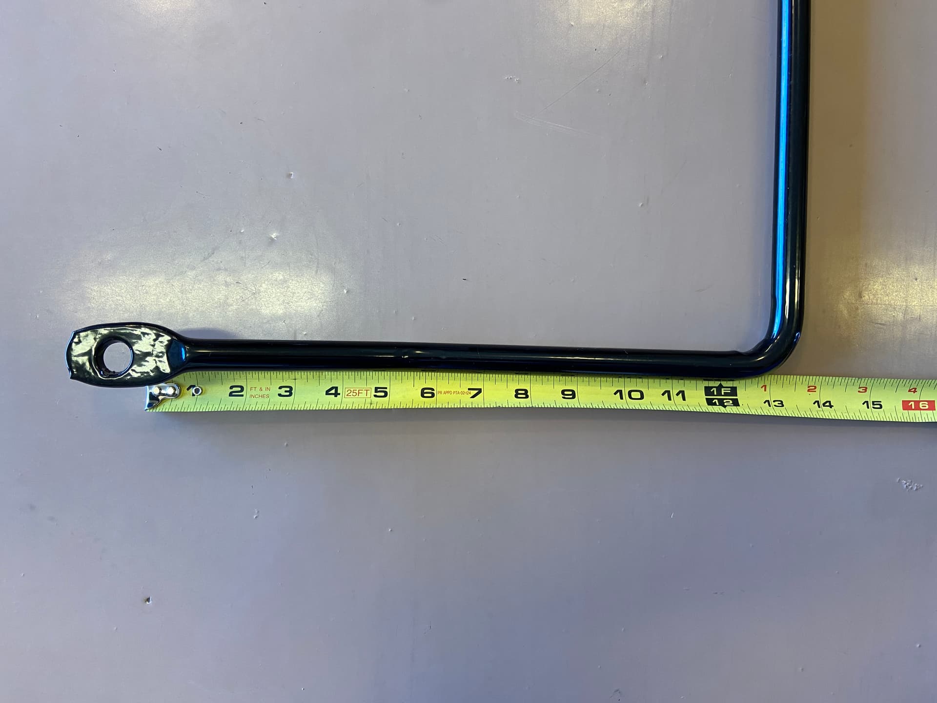

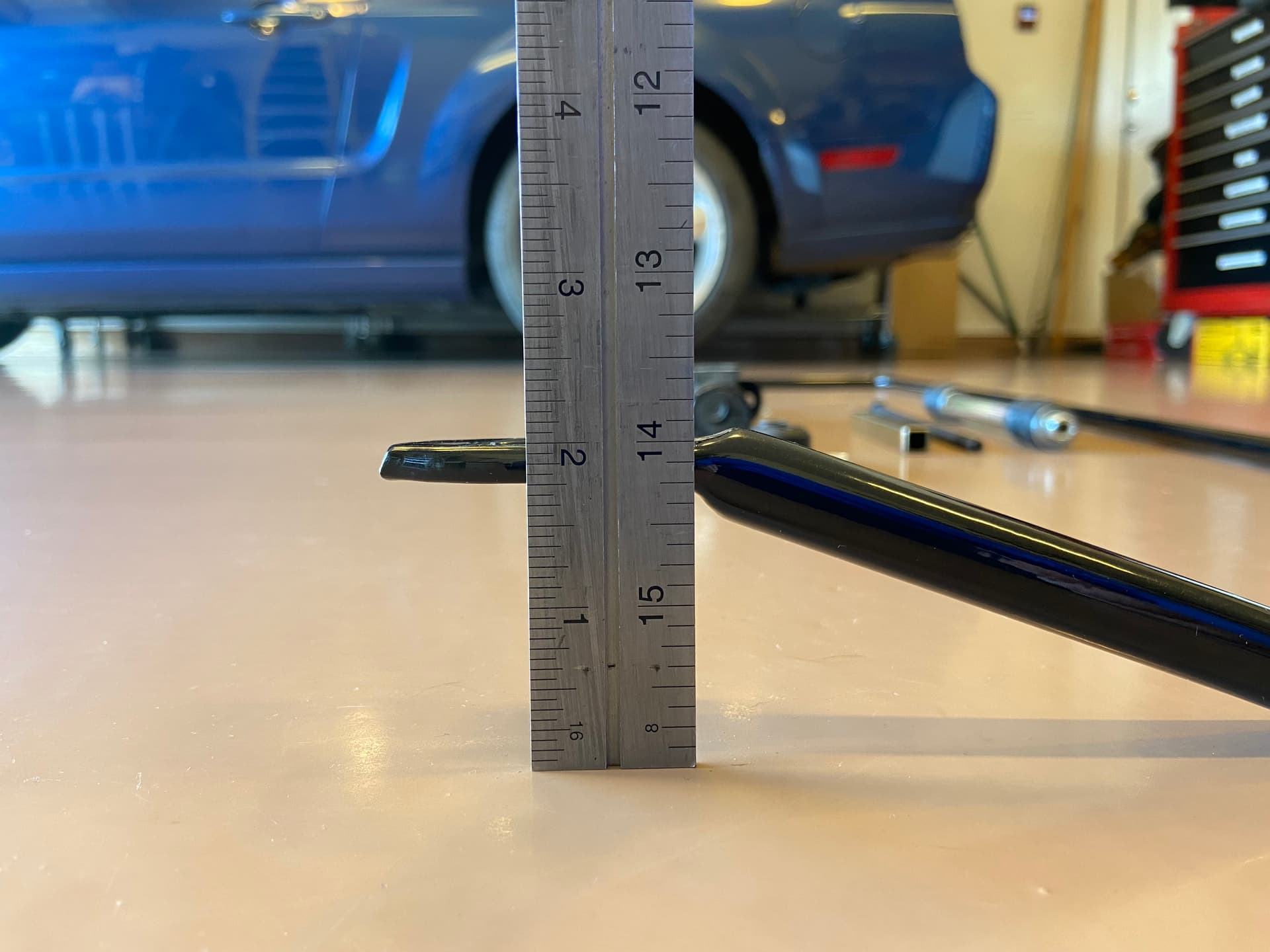

The Bar is 47.75” CTC Wide, 13.25” CTC Arm Length, with a 1.75” offset at the end of the arm. The bushing eyelets have a tapered hole starting at about 5/8” down to 35/64”. The Bushings have a shoulder just under 5/8”. So the fit in one end but not the other. The End Links are shorter than stock with what ADDCO calls 8” FH (Functional Height) The bolts are 3/8-16 X 11” with a square tube spacer that is 6” long, 9/16”OD, ½”ID. The End Link washers are flat rather than the stock cupped washers.

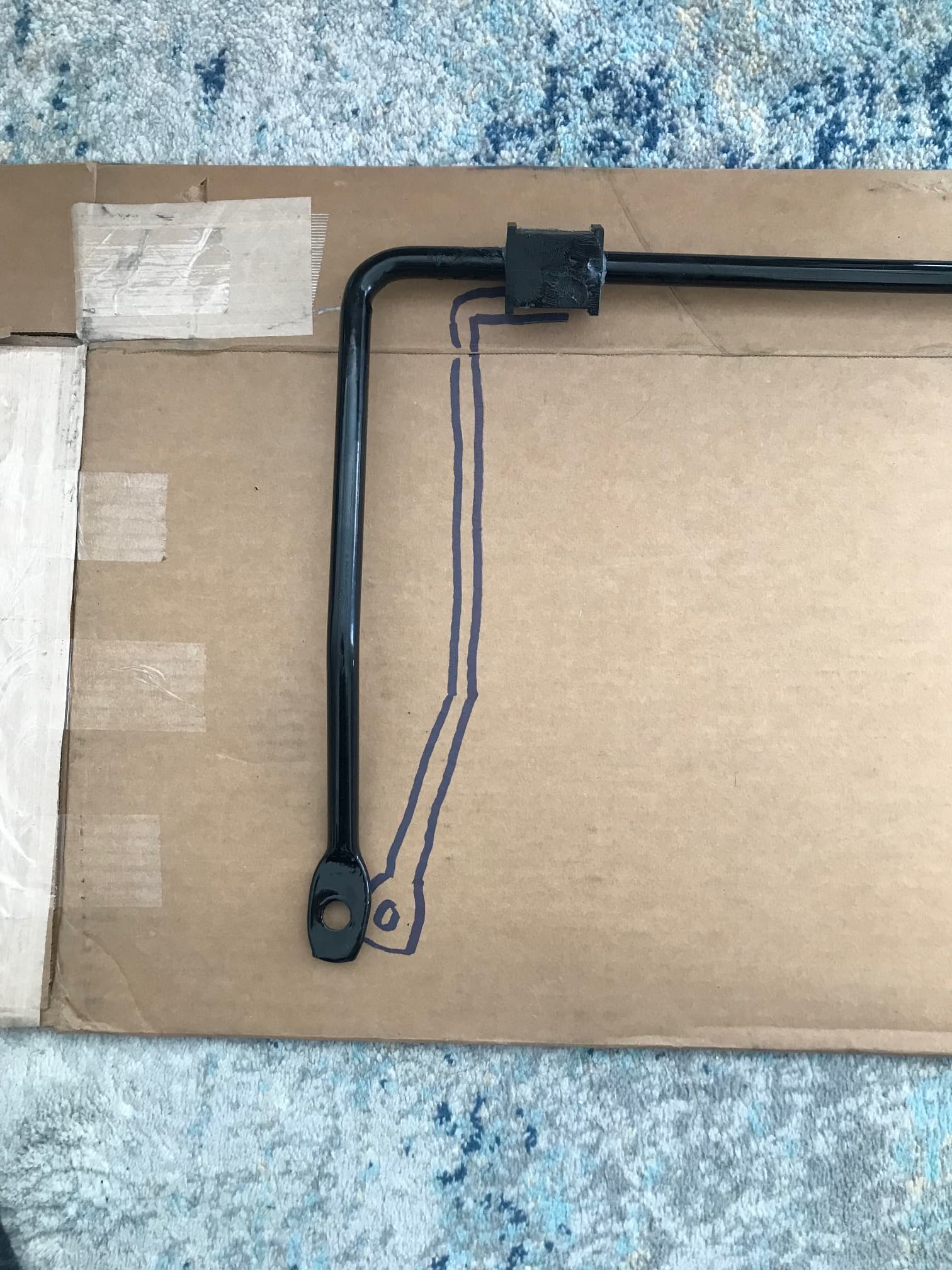

Is this comparison to the 432 bar outline?
Is this the new version of the 432 outline or of the older one?
432 has a bend near the brackets and is not straight like the stock bar. 432 will NOT fit '69-'70. The new bar is bent exactly like the '69-'70 stock bar and is 5/8" vs original 1/2".
The ADDCO K2-614-0U Cougar 5/8" bar fit my '70 convertible with P235-60x14 tires and 6" factory SS wheels. Previously, it had a 1/2" factory bar from a 1970 Boss 302 Eliminator.
It bolted into the OEM holes. I wish the bend radius was more like the factory instead of 90 degrees for more tire clearance.
