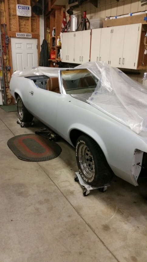

Hi All,
So this last weekend I reinstalled my pump,lines and cylinders for the convertible top after years of being on the shelf in a box while rebuilding the rest of the car.i removed all the old fluid, and replaced with transmission fluid, cleaned everything and bled the lines. Once I hit the dash switch, I’m happy to say everything came to life. There are a couple things I’m unsure of. It’s been so long since I dissembled it (13 years) I couldn’t remember which cylinder went on which side. Yes I know I should have marked them but, does it really matter? Secondly, one of them is leaking through the ram seal. I was wondering if the seal might swell after being introduced to fresh fluid, from what I read, everybody seems to say I should replace both sides. The price seems to be all over the map for these from $119.00 to $149.00. Is there really a difference? I’d like to stay within the US for manufacturing, Can the OE’s be rebuilt? Like many of you, I have way too much time invested in this project. I may have stopped years ago but people have told me I’m crazy…that just motivates me more. The last thing I want to do is have it all painted and fresh interior with a top that won’t close and a ram that leaks oil. Any advice would be appreciated but I’m guessing I best budget for a new set.

It does matter which side they go on, they cannot be rebuilt and have found one of the cheaper brands to be a tad too short.

I discovered that the hydraulic lines for the top mechanism become brittle over the decades, and burst shortly after everything is put back together. I don’t know how common that is, but you might consider spending another hunny and replacing those while you’re at it.

The rams can be rebuilt if you’re brave enough to do some cutting. Basically, you have to cut the very top of the cylinder to remove the head. Then you can change the seals. To reassemble, you re-crimp the cylinder to the head. I rebuilt mine a year or so ago and the work perfectly. I posted pics of the process somewhere here.
