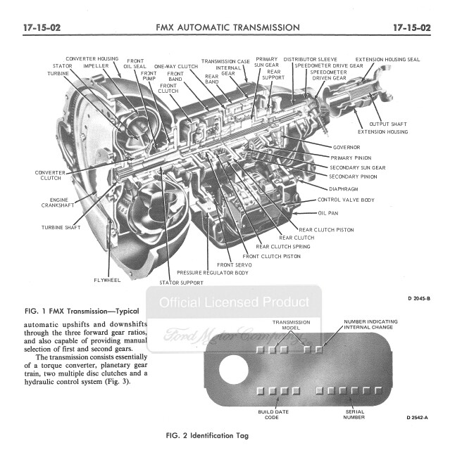

I was following up on Grim’s last e-mail so that I could better aim my camera. It dawned on me the VIN would have the transmission code. Code “X.” Yep. FMX. Color me a light shade of embarrassed for not thinking of that earlier!

As for your weepy FMX, the cure is annoying but simple: You probably need to replace seals.
From what you are describing, I’m going to bet it’s the front pump seal that’s the real ‘problem’ here, allowing fluid to leak out of the torque converter as she sits. But then as fluid levels in the rest of the transmission get overfull, it leaks out of other leaky seals like the shift select lever O-ring, and maybe even the filler neck seal.
Fixing these is actually super simple, but it’s also a pain in the rear, since you will have to 1) take the transmission out, and 2) have a nice clean worktable that can have messy transmission fluid poured all over it, and won’t mind having heavy metal parts drug across it.
Even an “empty” transmission that’s been drained is still a royal mess, and will leak red stuff all over the place when you work on it.
These transmissions are actually very simple to work on, for the most part, and don’t require a lot of weird tools. The basic seals and parts are also not super expensive. The FMX used a Ravineaux twin planetary setup, unlike the C4 and C6, but it’s still pretty easy to deal with. If you choose to work on it yourself, you might as well check to see if it needs its friction materials replaced, and put in a shift kit while you’re at it, to ensure long life and not have to get in there again for a long time.

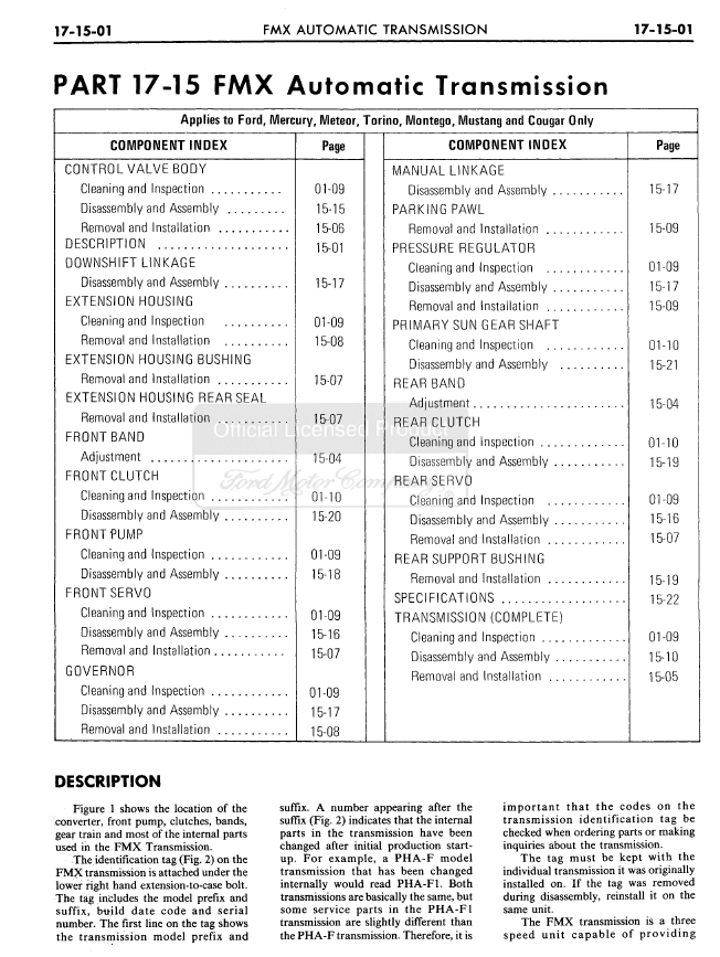

2 things for you to help with your troubles. First, get the '72 FSM. They are dirt cheap on Rockauto and worth it’s weight in gold. Second, check out Ken Collins at Bad Shoe Productions. He has a video for FMX rebuild. Just pop it in a portable dvd player and follow along.

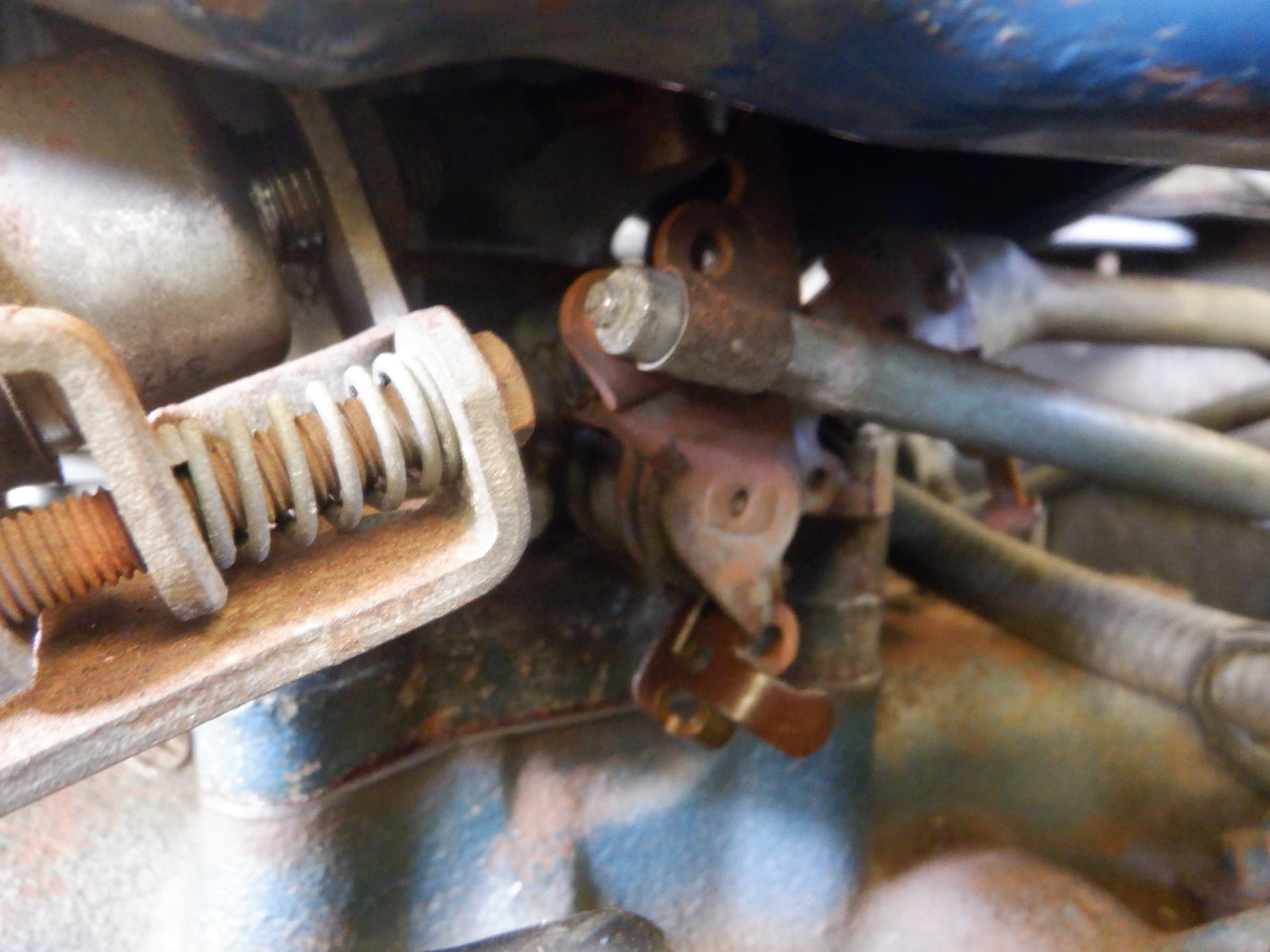

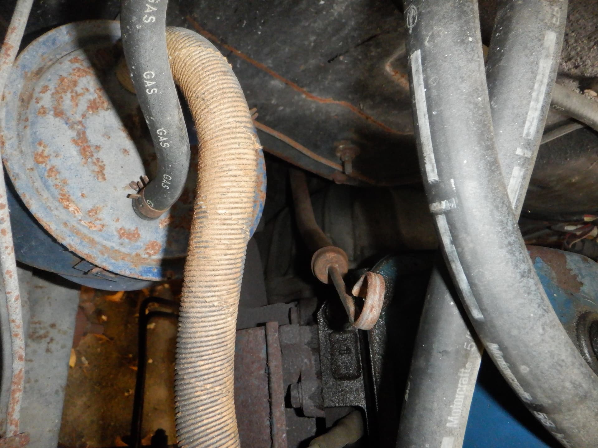

There is one other point I should bring up. In my original post, I neglected to mention that the kickdown rod had become disconnected from the throttle mechanisms. I found the clip and reattached it.
Because I had assumed this was non-diagnostic, I left it out of this thread. Is it possible that this was loose for some time, exacerbating the situation, and then simply fell off just before the car effectively stopped shifting at all?

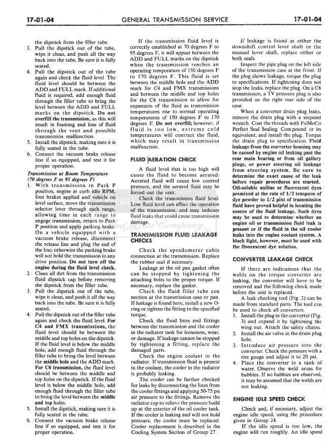

Be sure to only check the fluid in that transmission with the engine running. The fluid gets pumped into the converter and other places, out of the pan while it’s spinning. If you check it with the engine off, the dipstick will show that it has more fluid than it really does.
Don’t overfill it either; it will foam a lot, and do strange things!
