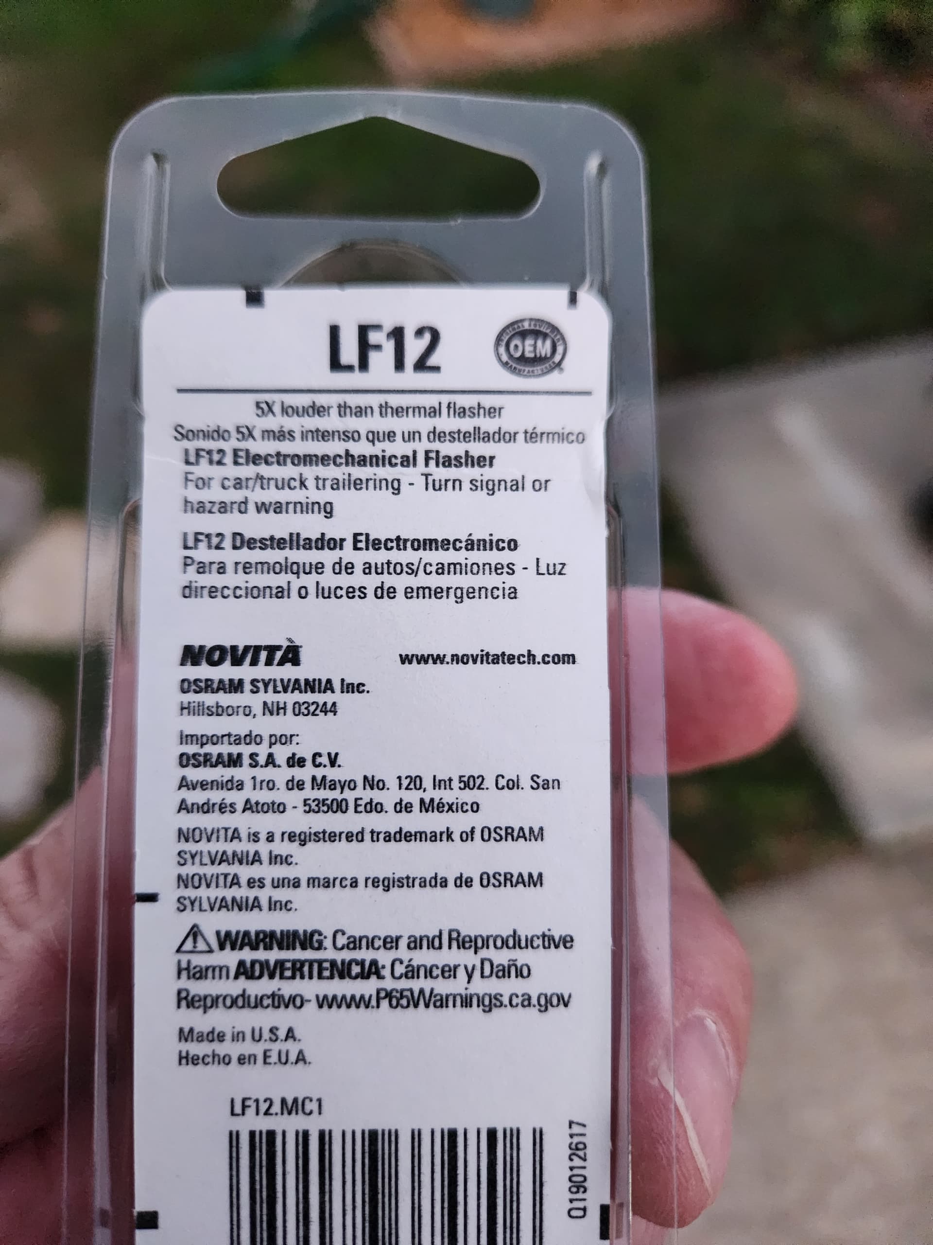

Yes engine is running. I am going to try a new flasher. Its green so it may be the original.

A new flasher fixed it guys.
