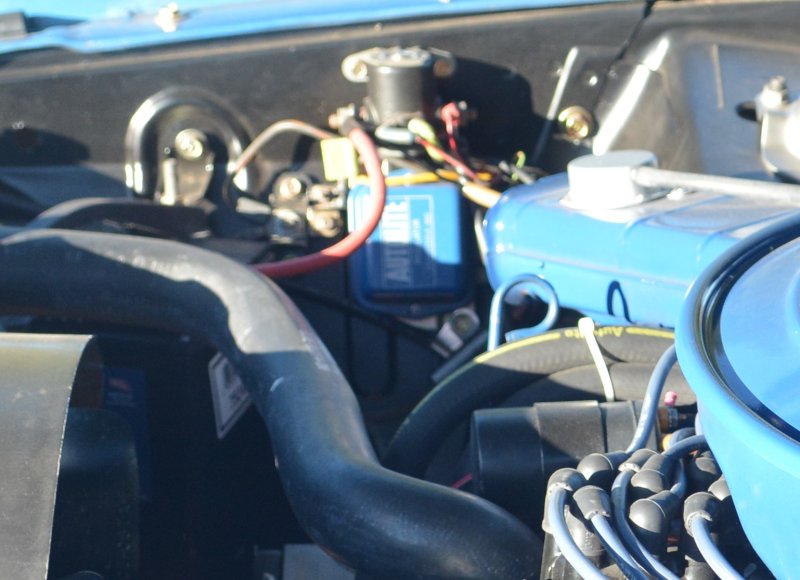

I know this is not a clearly focused picture. It is cropped from another bigger picture.
If you look at the lower fastener holding the voltage regulator to the apron you will see the negative cable lug attached to it. The negative terminal is toward the front of the car, the cable snakes along the outer side of the battery, attached to the regulator fastener then to the block.
I hope this gives some clarity to how the cable is run from the factory. Note, this is from my 71. I replaced the original cable with a reproduction when I restored the engine compartment. I duplicated how it was when I got the car. The cables both still had correct D0ZF Ford part numbers on them.
