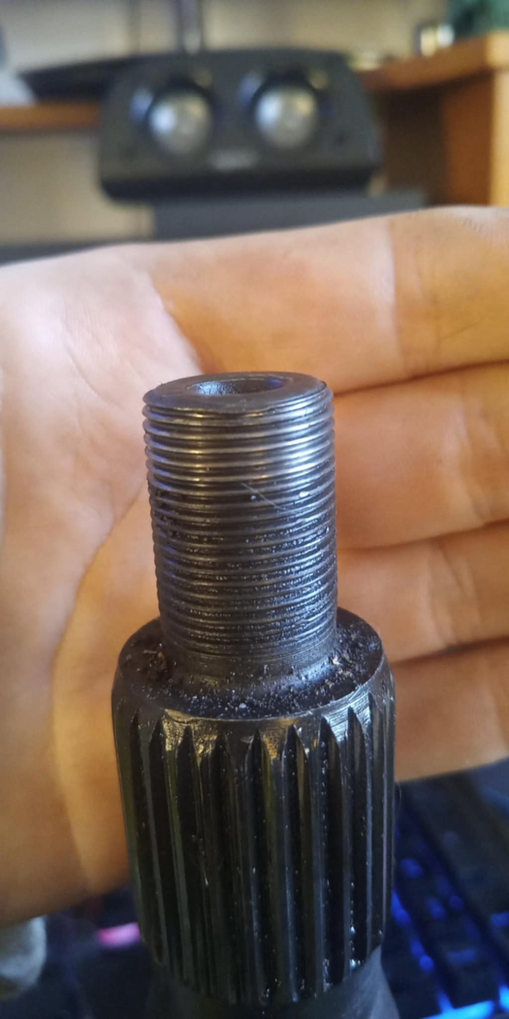

I got a new nut and started working out the preload setup. Until I tried to screw the nut and it didn’t want to screw n after a few turns.
Then I went with the old nut to try and still it wouldn’t thread…
Turns out the very first thread on the pinion got messed up !
Now my mission : saving the pinion !
Does anyone know what size die cutter I would need to try and straighten this thread ?
Or maybe i could file/grind flat from the top until I “erased” the bad thread ? i don’t know
I believe it is a 3/4"-20
I’ve saved worse than that by chasing threads with correct size die. Good luck!
