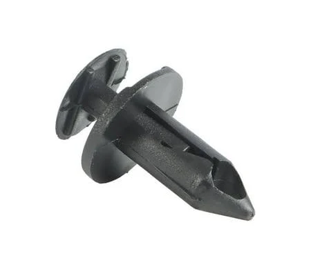

no sadly. They are a 2 piece black plastic retainer. One part goes into the round hole (one per side), followed by a locking pin that goes into the center of the 1st piece. Lot of these got destroyed during removal. Try a plastic push retainer for w/x or??
Bill, you wouldn’t happen to have a photo of the two piece clip? There was quite a few different clips and screws under the carpet - I might still have them!

Long time gone, sorry I’m just now seeing it. They look something like this:
No problem. I figured it out with the expert guidance.
