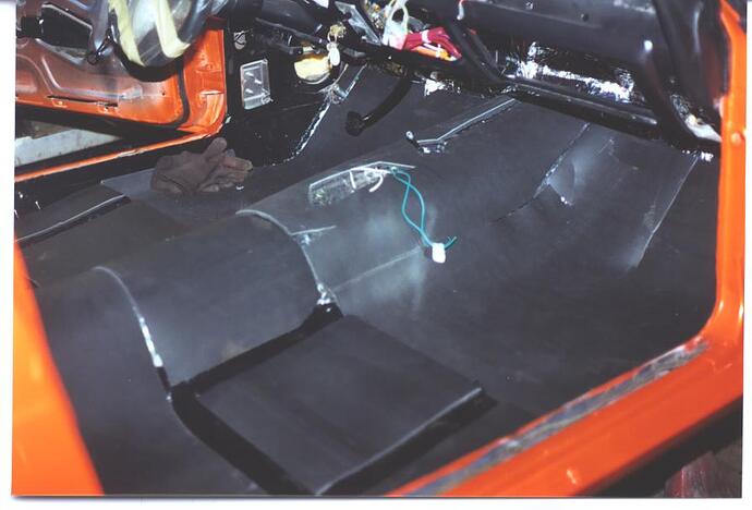

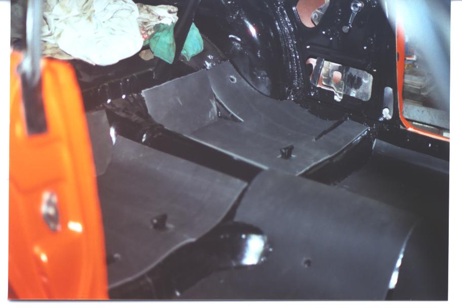

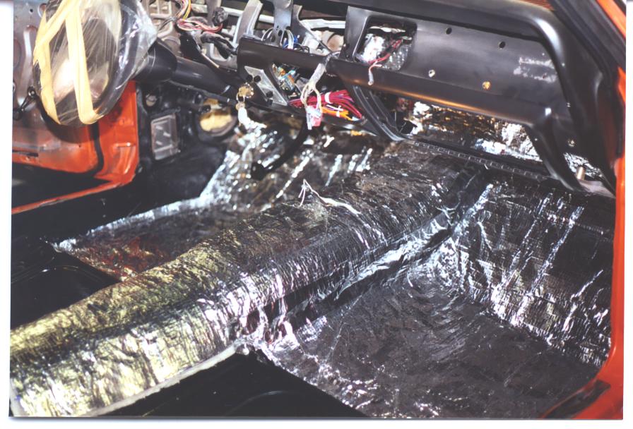

Thanks for the detailed reply. You mentioned that you insulated the car. What did that involve? I heard of this, and possibly upgrading the alternator and fan (in a car that did not previously have AC).
Thanks in advance.
I agree on the upgraded radiator and alternator. While I run a small block, I’m running a three-row radiator. I also upgraded to a 100 amp alternator since I also have an electric fuel pump, MSD ignition, the AC, and an overkill stereo with two amps.
As for the insulation, I used products from a company that I fear is no longer in business. It was called Insulshield Technology. I used one of their foil-backed firewall blankets from the base of the windshield all the way to the front seat risers. For the floor I used their closed cell foam carpet underlayment. I also have dynamat behind the door panels, in the trunk, and on top of the steel firewall I made for behind the back seat. All of this was done as part of the build and remains unchanged 20 years later.
These are all scans of photos way before I had any type of digital photo making device.
