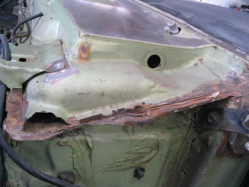

Here’s a pic showing the hole in a early 67
There’s another, bigger, access point at the lower left in the picture just above this post.
