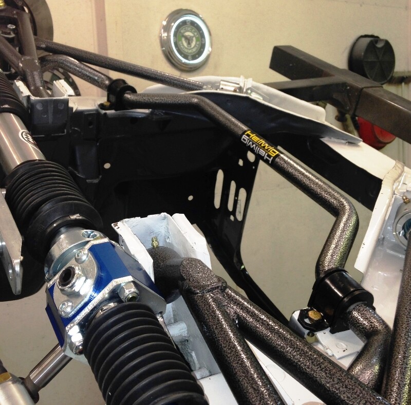

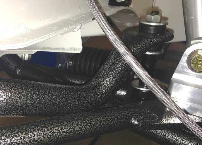

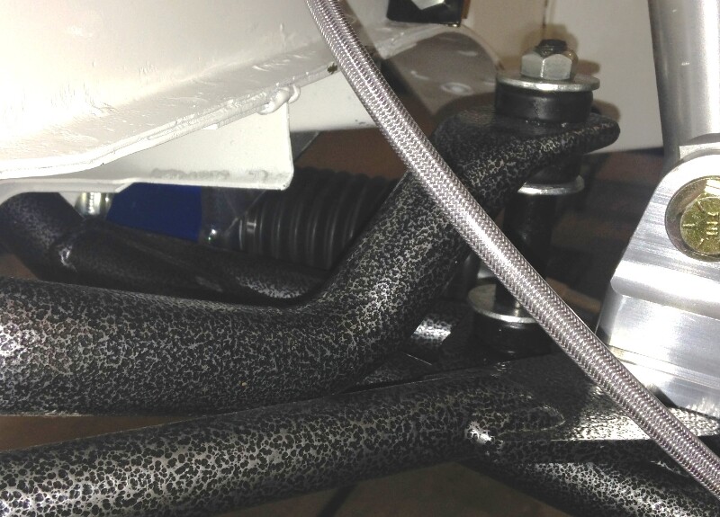

I had trouble with my Hellwig bar hitting the TCP strut rods. Worked with both Hellwig and TCP and they came to the conclusion that the Hellwig bar wouldn’t work with the TCP strut rods. I had the largest Dia bar they offered as well. Had to exchange it for the TCP sway bar that was bent different and a little smaller Dia.
Thank you VERY much for taking the time to do those pics (nice looking set-up!). I love the TCP gear, just not the price.
