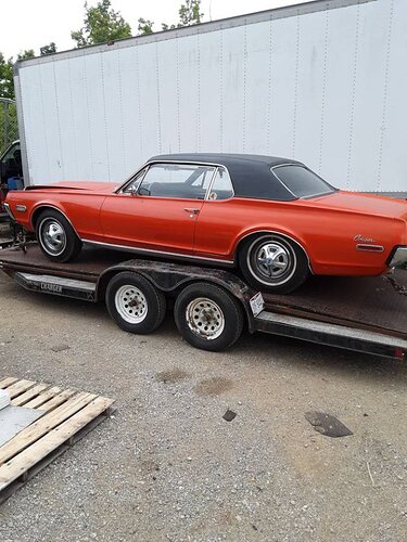

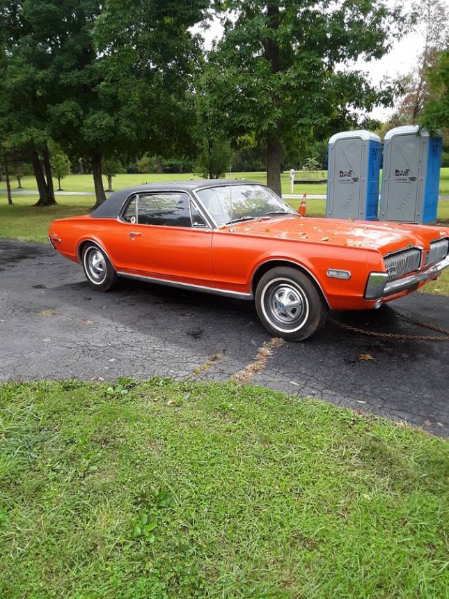

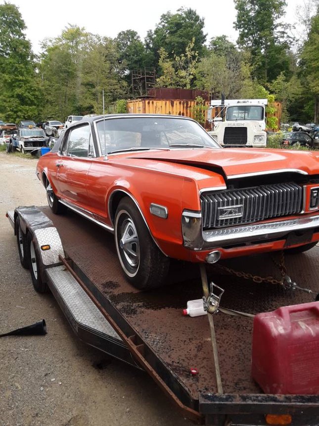

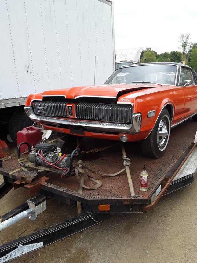

Looking for advice on what I might need to keep an eye out for with 68 I have a line on. It’s a base model with a 390, or at least that’s what the seller says. Not clear yet if it’s 2 or 4 barrel. Told the floors need replaced but from the pics the rockers seem solid. Have not seen the car in person.
Any constructive advice is appreciated. Verifying the car is not a chop shop special is a big concern i have. It will need some work, and I’m not afraid to get dirty. I just can’t really afford to sink money into full on restoration. I don’t need a show car, but would like to have a driver that’s a nice 10 footer at least when I’m done.
Here are some pics of what I am considering checking out.
From the pics, the car is sitting low in the back. Is the motor in the car, because it doesn’t look like it from the pics. If the motor is in it and it’s sitting like that, I would check the rear springs and make sure they aren’t sitting in the trunk due to rust. Vinyl top, I would look very carefully for bubbles, especially around the back window and where the bottom trim is. Rear quarters and floors are always a concern as well as torque boxes.
The car looks good it the pics, nice chrome and what looks to be good paint.
