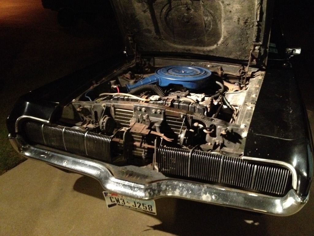

  1. That’s a cleveland. Note the radiator hose going into the block, straight down, rather than into the intake manifold. That’s one of the quickest way to tell between windsor and cleveland.

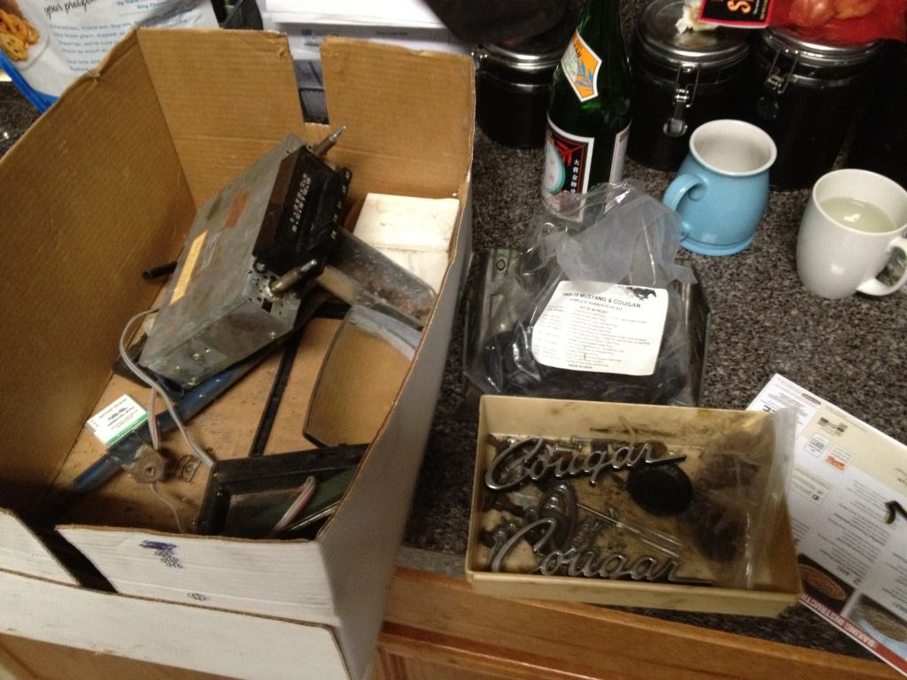

Well I am one happy buyer…I drove out to the boonies 60 miles to look at it. First impression was skeptical. But as I looked in the wheel wells for rust in the trunk…looked great, tapped everywhere for holes…felt solid. I got to the interior, the door seals are are solid and the door opens nice and firm, and shut like my 06 infinity. The interior is suprisingly good…The kid rolled out the original spare with poly glass tire, and drug out a box of parts, with a original AM/FM radio, spare emblems, existing trim, new body lpug kit. The trunk trim is off but in the trunk. Car has a new gas tank, new AC evaporator. I sat in it, and fired it right up. let it warm up, looked for leaks of oil tranny fluid, coolant, etc…I took it for a test ride, brakes felt pretty good, steering a bit loose and carb seemed a little hesitant. i got it our on the road, and man does it run, nice and smooth power, drove sraight as an arrow, and purred down the road. i was suprised of the power. Car has dual glass packs so it has a nice rumble but nice quiet idle.

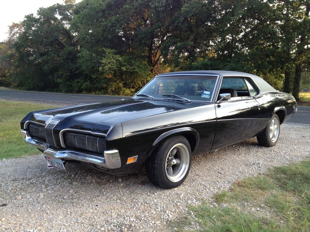

Before I bought it, I spent a good amount of time looking for rust. I was able to get under the dash and look through the vents with a light and look through the cowl. There looked to be light surface rust. Now, the cowl is clogged (under cowl vents) with leaves and junk, Im sure the cowl is the cause of the rusted floors. The underside looked good too and the torq boxes are not rusted. I will dig in to it come winter time. Until then we are going to drive this car EVERYWHERE and enjoy every minute.
The paint, is flatter on top and shinier on the sides. Looks like an older paint job that has potention to polish out (will try tomorrow). Car looks as good in pics as it does ni person. Overall I feel I got alot of Car for the money.
