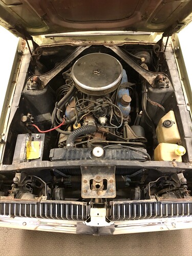

I’m not sure exactly what to do here. The car runs great, until I quickly stab the throttle. When I do that it has a split second hesitation, then takes off. It had a motorcraft 4300, that I replaced with a new holley street warrior.
I’ve had the aftermarket air cleaner on since the rebuild and wondering if an original will be better. If someone wants to critique what I’ve got, I’ll gladly take notes.
I will respect your advice, too, as I’d like this car to be better.
Here’s a few pictures. One of them is when I got it.
If its only when you try to stab the throttle or first open to WOT, I’d look into adjusting the accelerator pump on that holley, either a larger nozzle, or if it’s close enough perhaps just a different cam on the lever.
They have multiple cams here that change how aggressive the accelerator pump will deliver the extra fuel.
https://www.holley.com/products/fuel_systems/carburetor_components/accelerator_pumps_nozzles_and_booster_parts/accelerator_pump_parts/parts/20-12
Its also possible that the lever is out of adjustment, in which case you just get two 3/8" wrenches and adjust the nut and bolt with the red spring inbetween until it is contacting the lever. If it’s out of adjustment, you could be delivering the fuel too late, or keeping the lever depressed at idle and not allowing the diaphragm to fill with enough fuel.
Confirm that you are dealing with 6.5 power valve…if so then adjust accelpump to specs and go from there…you can lengthen or shorten pump shot with cam change or reposition…sometimes you need to change the nozzle size but stick with what you got until you exhaust cam changes….of course make sure your ignition and timing are properly set….and your idle vacuum reading is in line.
One more thing….the #7 and #8 plug wire cross….which could result in a misfire ….I always go 5-7-6-8 in the loom holder on the vc… btw…nicely detailed engine bay….
Generally this sort of problem - bog on throttle application - is caused by incorrect ignition timing adjustment. Anything that is done to the carburetor will not affect it.
Basic tune up technique is needed to fix the problem. Advance curve in the distributor, initial timing, centrifugal advance operation and adjustment, vacuum advance are all subjects that you need to become familiar with and then explore to see what they are on this car.

Redxr7, thanks for the wire tip. I changed it and now 6&7 cross.? The specs in carburetor manual say 65 for the power valve.

This was not anything to do with the carburetor. I was wrong and the problem never really went away, until now that is.
It was the timing, as noted above-thank you.
It started with a points resistance test, which showed bad. I replaced them and set the gap. Did a dwell test and adjusted the gap, again until it read around 29 degrees. Then used the timing light, which showed my timing was off a couple degrees.
