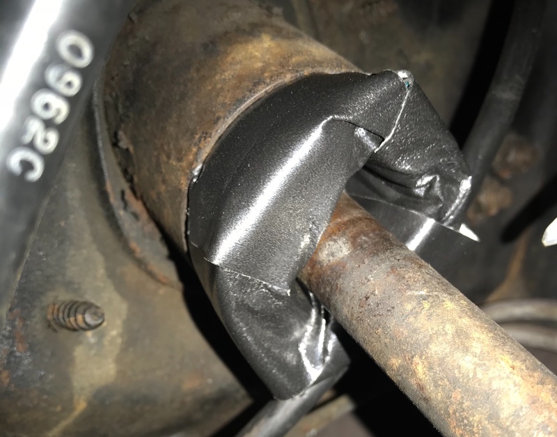

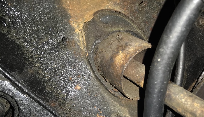

Hi all.
Tons of hot air coming in from this large hole where the steering wheel goes.
Is there a seal or plug that it’s missing?
There’s a foam rubber plug that fits around the shaft and inside the tube. When they rot away you get lots of hot air. You can either make one or buy one to fix the problem.
I used windshield ribbon strip to seal the outer ring and some pipe insulation glued, to seal the shaft. This is for a 69.

I used one of my kid’s foam pool noodles. It’s bright pink.
https://www.macsautoparts.com/ford_mustang/ford-mustang-steering-column-lower-insulator-rubber.html
Something like this. I made my own from pipe insulation from the hardware store.
Just tried it and that works!

It would be nice to let’s us know the year. I have the benefit of working in these daily.
That looks like a 67 so use a child’s swimming noodle. About a buck at Dollar store. Cut off about 3+ inches and push it up inside at least 3 inches.
For 68 and 69 use 3/4 pipe insulation cut about 2 inches and push in about 3 inches.
Thank you. It’s a 67 XR7. And I did just that. I used a noodle. I also wrapped some duct tape (so I wouldn’t see neon green every time I opened the hood).
Works like a charm.
