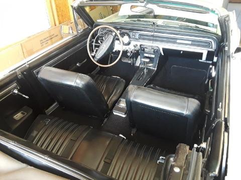

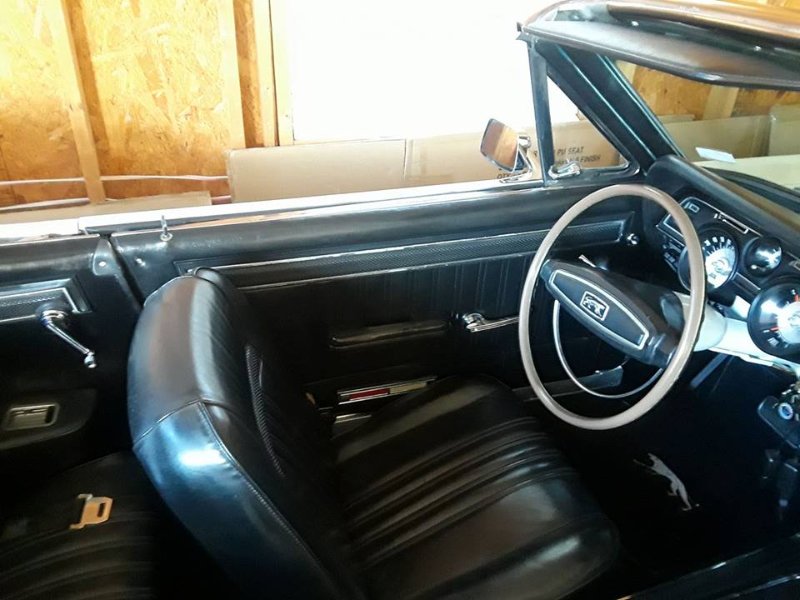

I have a 68 vert with most of the interior being from a 67, except the steering wheel and dash. The door panels were made to work with minor drilling. Can’t really tell the difference and NOBODY has questioned me yet about it. Then again, the car was originally a blue on blue hard top. Mods across the board here. I personally like the way mine was set up by the previous owner that did the conversion to convertible. There were things about the 68 interior I didn’t like, so mine not being entirely correct doesn’t bother me one bit.
If nobody questions you about it being a convertible I doubt they know the difference between the interiors. Is there more pictures posted somewhere? Nice looking car from what I can see.

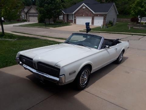

You make a good point. We do take the car to shows and rarely will someone question it being a convertible. As for interior, nobody is none the wiser. I put pics up on my facebook account every now and then. This car was April 2017 Car of the Month on this website. Much different from two years ago and constantly being upgraded. :dance:
