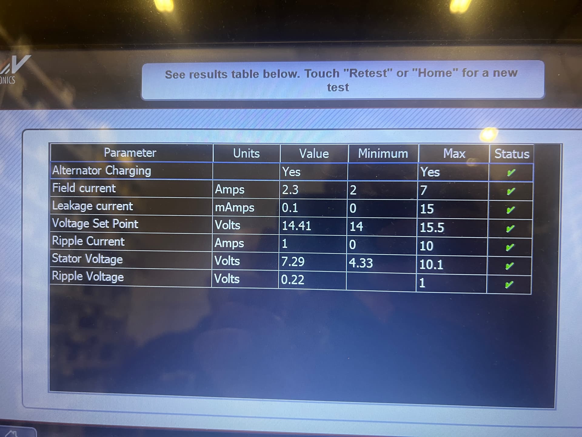

I finally found time to remove the alternator and have it tested.
They said it’s working.
See picture.
I’m guessing the next step would be the voltage regulator??

Your battery voltages look fine, and alternator tests OK. So assuming everything is wired up correctly, the voltage regulator is the most likely problem. The yellow stamped repros are a bit heavier duty, but should work even without air conditioning.
