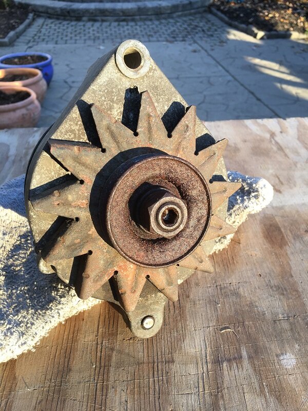

Reality check. I’m not going to be able to rebuild my alternator this winter as planned.
I’d like to send it out to have it rebuilt.
Any recommendations on who to use?
It’s the original from a 1968 Cougar XR7 302 without air.
No known issue with it, but wanted to have at least the bearings, brushes replace and the unit tested.
Its been on the car, unused for 40 years.
It also needs to be cleaned up but not a full restoration.

Question for those who have rebuilt their alternator, do the castings have Autolite cast into them? I have some with no markings and some with motocraft but none with Autolite, I’ve seen ones with the Autolite ink stamp, which would be correct for 1968? Thanks in advance.
For 1968, no they do not. No markings as to amperage either. All of that was ink stamped in 1968. The housing has a distinctive tear drop shape cast in the rear face. The arm on the front face where the belt adjustment bolt threads in is rounded on the bottom.
