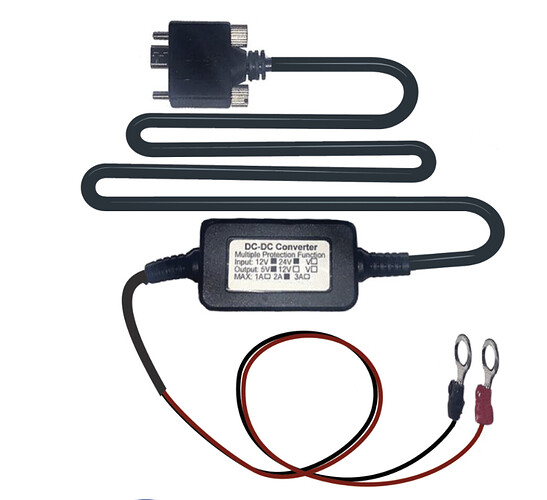

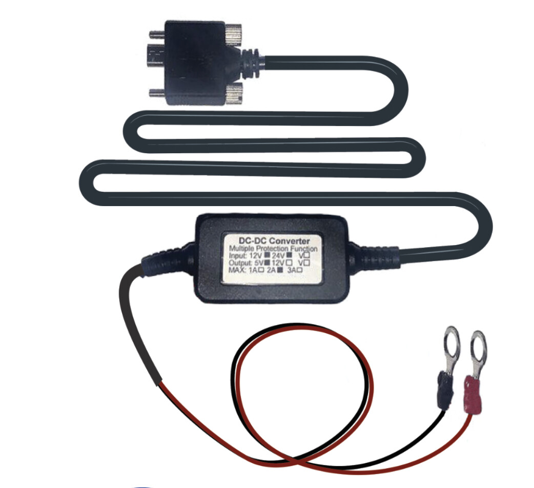

Read the specs on the air tag…I’d recommend something like the amazon link I posted prior or similar so you can track it The TKSTAR unit even has an alert sensitive if someone sits in the car goes right to your smart phone I’m going with the below unit
Is that unit about $30? Then a monthly charge? Does it need to be on the cars electrical system, or is that just an option? Thx
Yes and Yes . It has a battery and a usb cable to charge it, or you can hardwire it with the additional adapter below
