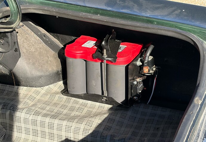

Just completed mine a few weeks ago and everything is operating great. Below is my wiring schematic. To me the big advantage is if I’m at a hotel or anything like that, I can flip the breaker in the trunk and cut the power to the whole car. I ran my wires down the trans tunnel.

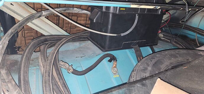

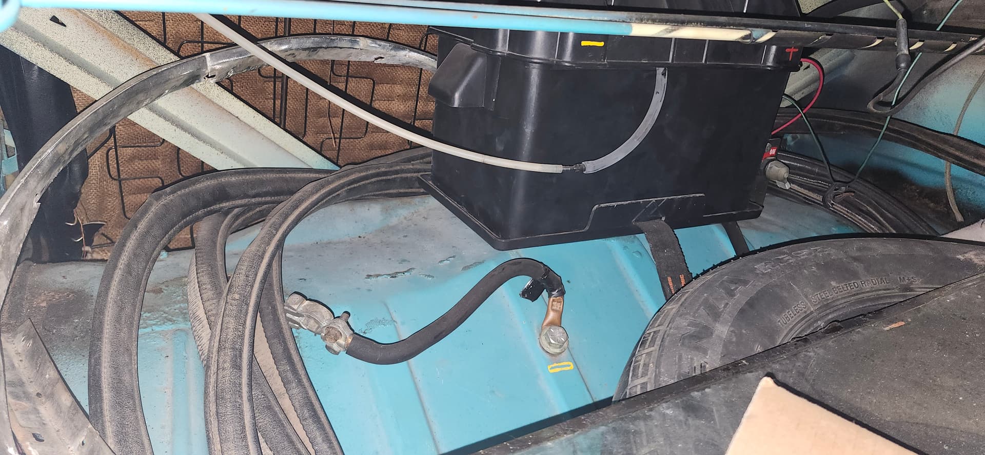

I used a marine battery box I found at the local boat store in Texas. Lots of boats stores there. Then to the welding shop for 15? feet of .575 od fine wire cable 600volt.

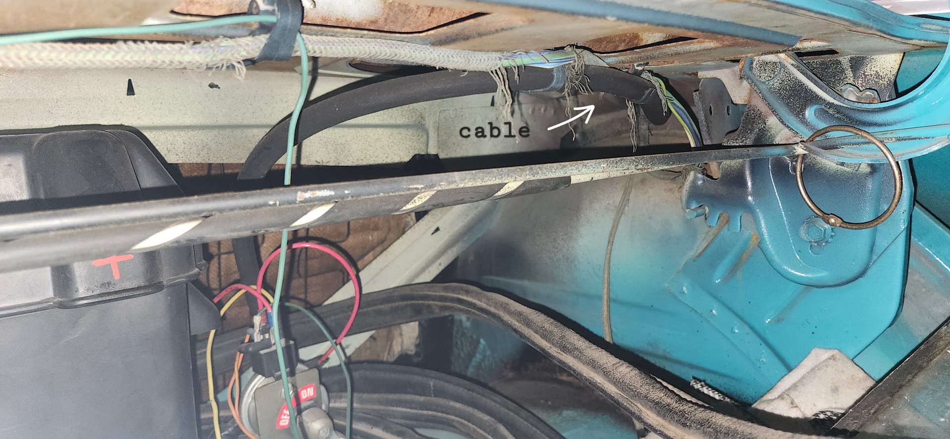

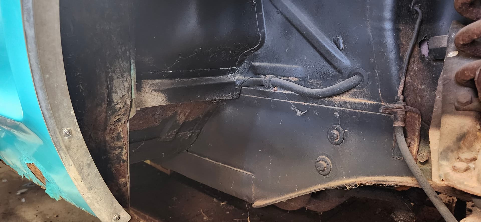

First hole was drilled behind the right shock tower. A grommet was installed and I made sure the cable sat comfortably straight through the apron. In the wheel well. An aluminum plate was made to shield the cable along the foot well. The second and I belive last hole was drilled through the kick panel. From there the cable ran past the antenna and through the rocker under the door sill plate. Through the ÂĽwindow area and up into the trunk by way of the hole in the sail panel already provided.

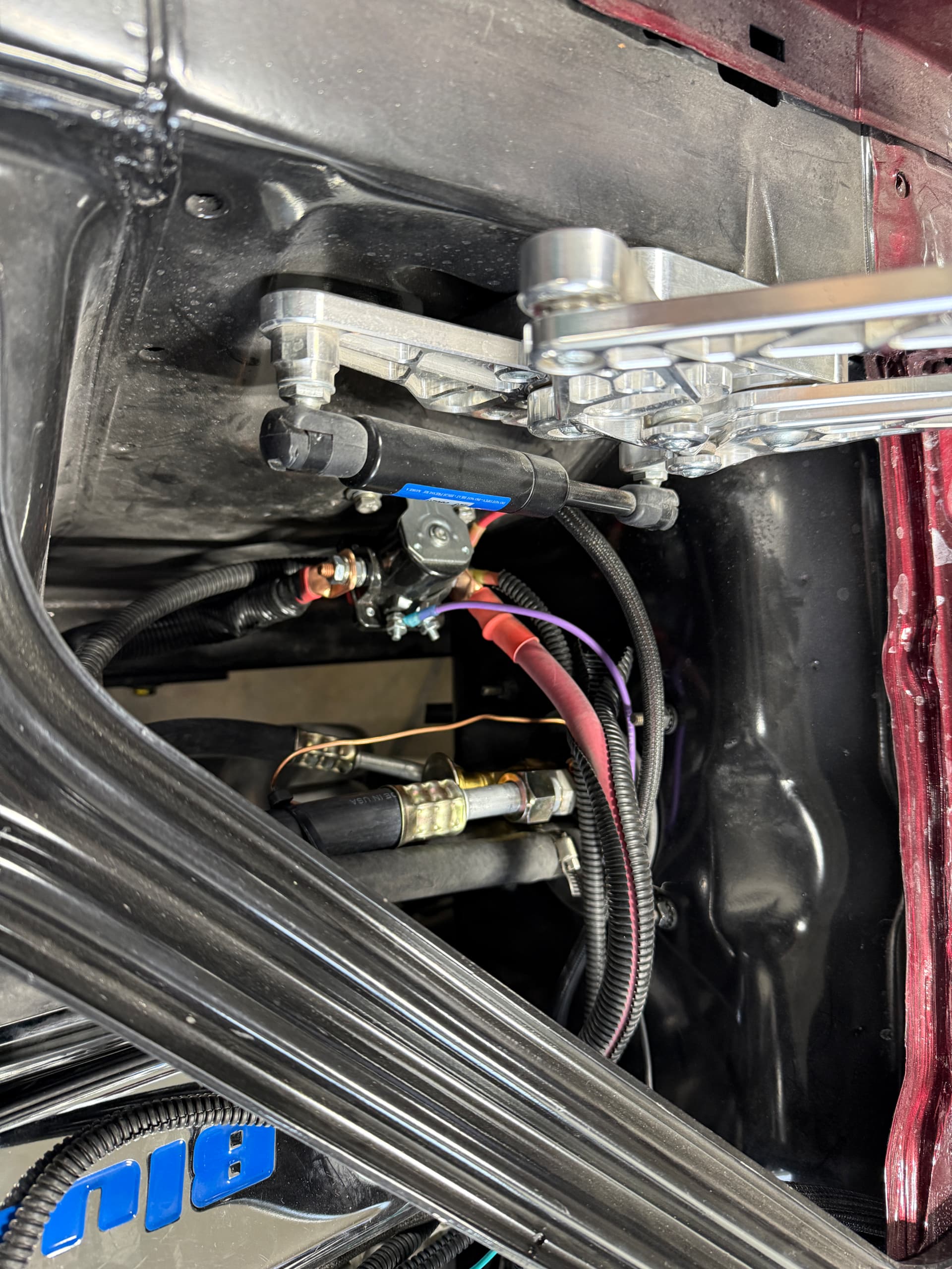

Since I was using an electric fuel pump I put in a primer button for it. Push the black spring button and the pump runs. Very useful. Then made a bracket for the relay, button, and cutoff switch. Mounted everything above the differential. The battery I sourced was for a BMW I think. It had a closed gas top that I could then run the vapors from the battery directly out of the trunk to the drivers side trunk drop down. As you can see, the ground was short.

I also added a brace under the outer part of the trunk pan ledge for added support for the heavy battery

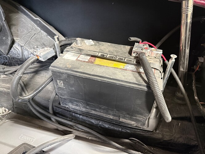

A bit late to the topic, but had to gather some info. I purchased through Summit Racing a Billet Battery Box GRP 27, EMS-MS374-81MB
This is not the permanent battery, and a cutoff switch will be added.

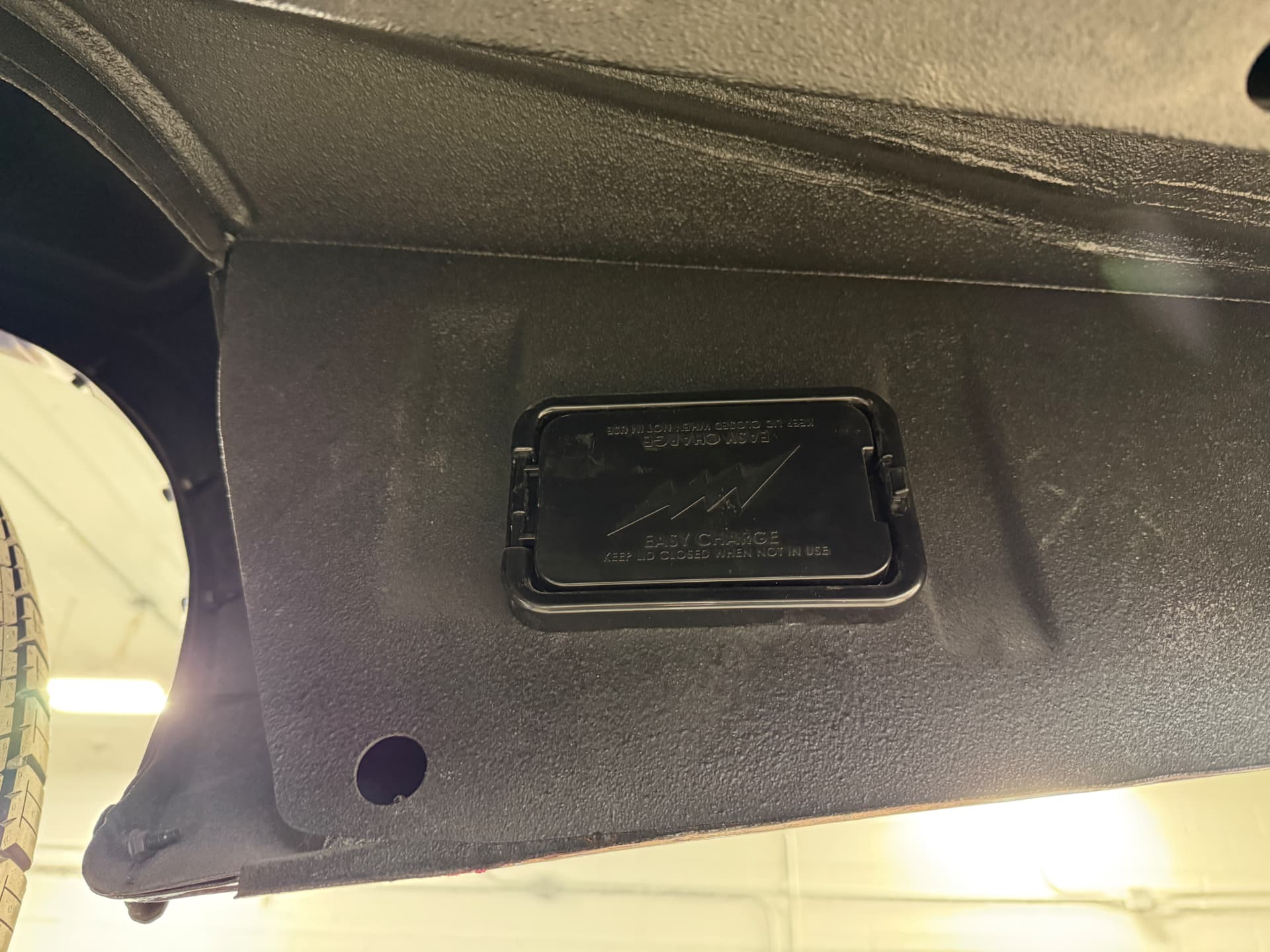

I also purchased a Remote Power outlet box, EMS-MS302-31BK

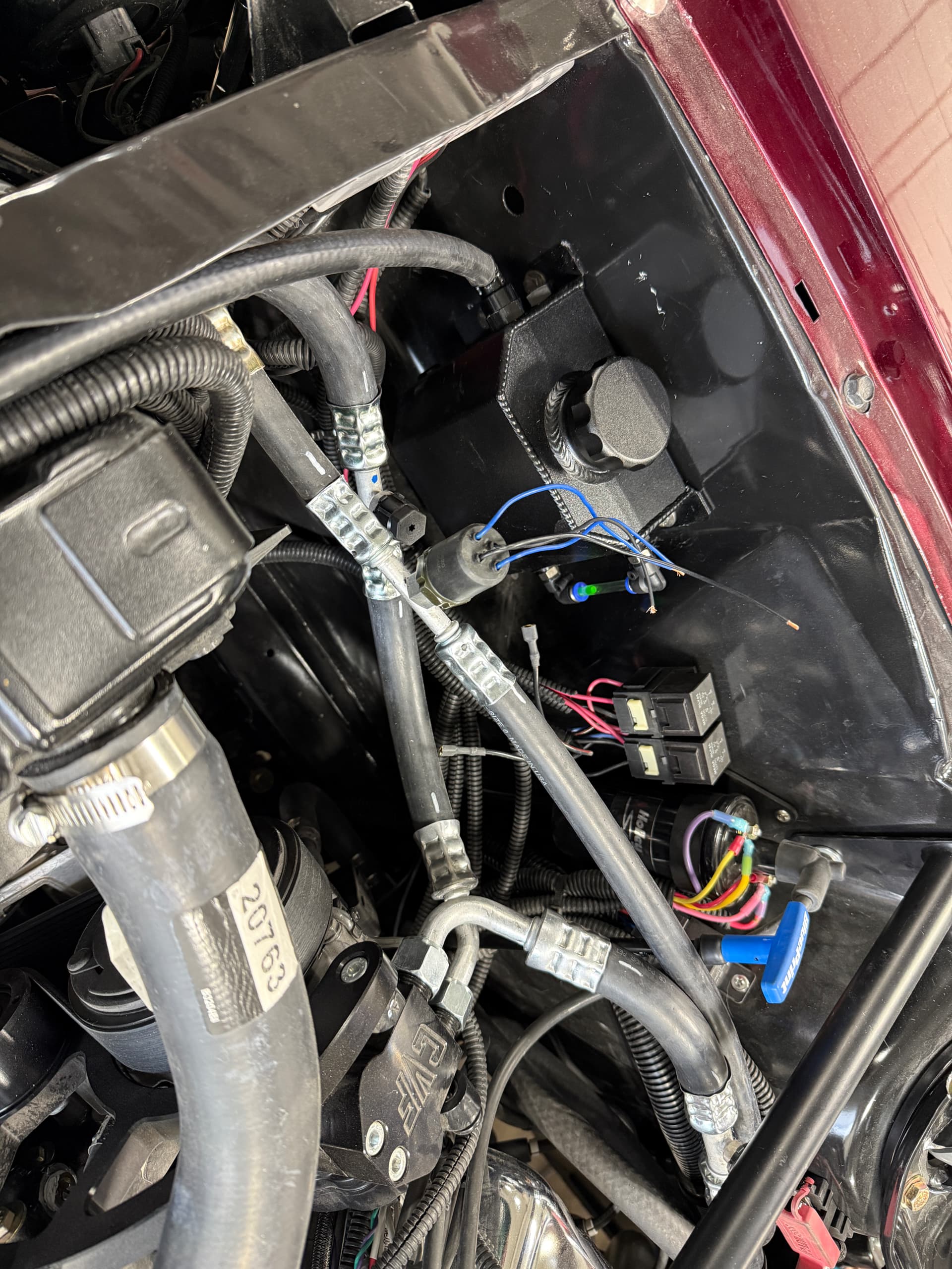

While I had the battery mounted in the trunk as a balance issue, it turns out it was a fortuitous decision. With the addition of A/C, going to Hydraboost for brakes, and the Rack & Pinion P/S, there was a lot of real estate being used up.
above is the radiator overflow where the battery would have mounted. Note Trinary switch is not completed yet.
1gauge copper cable is run under the carpet, Positive and Negative separated by the transmission tunnel. This to eliminate RF interference to the Snyper. Ring Bros Billet hinges.
