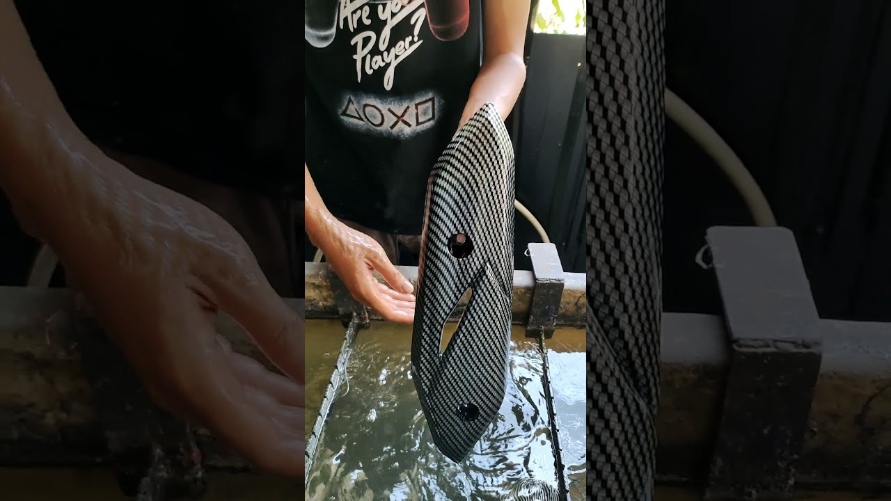

Here’s a link to what the process looks like: 15 seconds long
And a link to the product. There are a few burl options- this looks closest to the standard grain.
https://www.amazon.com/Hydrographic-Dipping-Transfer-Printing-Decoration/dp/B08KYLFM7Z/ref=mp_s_a_1_9?keywords=hydro+dip+film+walnut+wood+grain&qid=1706462335&sr=8-9
