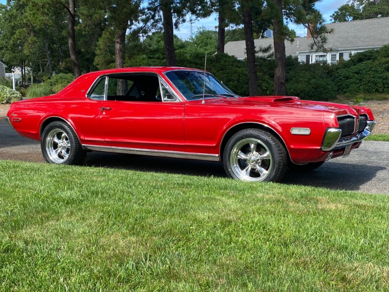

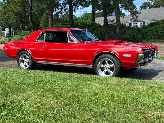

Not exactly to your specs your looking at but this is mine on 17x7 4”BS 225 front and 17x8 4.5” BS 245 rear. Front is lowered in total just shy of 2” with springs and Shelby drop. Rear is lowered 1” with a block.
Also think there is a tire and wheel thread around here somewhere that has several examples posted
Still got room in the rear for more rubber. Will change the tire size on the next set.

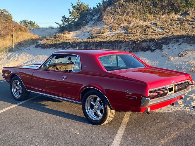

I chose to go with the AR torq thrust IIs, in a 0mm offset 17x7 (4” bs). I was originally going to run 17x8 rears but I got a deal on the 17x7s that I absolutely could not refuse so I went with 7s all around. The rear tires are 245/50 and the fronts are 215/55s (Sumitomo). I want to lower the front a tad more but I’ve been really lazy and haven’t done it (I’ve cut 1/2 coil off when I had it apart). I occasionally get some rub on the rears with a rolling bump hit at speed, I believe it ever so slightly touches the fender lip. I don’t drive the car enough to really worry about it.
These look great. I surprised that you are getting tire rub in the rear with a 7" wide and a 4" Back Space.
