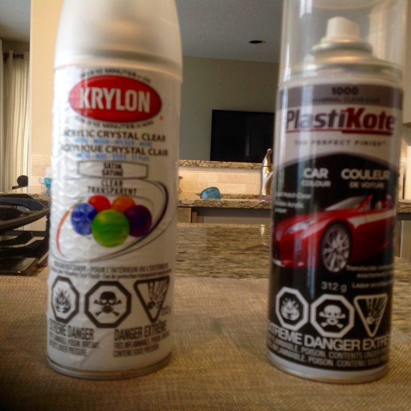

So I am now at the stage of finishing off the steering wheel project. Looks very nice if I say so myself. I need advice on whether I should apply a clear product over it.
I have two different ones on hand,Krylon Acrylic Crystal Clear and PlastiKote Universal Clear Coat 1000.
Thank you Bill
I did, but I used a base/clear paint system. Not sure what paint you used but I guess if you do and the clear doesn’t take you will have to sand it out and re-shoot the colour. The clear will add extra layers of clear paint and should provide more wear resistance. Bonus is it will come out nice and shiney.
Yeah I’m thinking the clear has to be compatible. Most clear on its own will yellow.

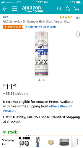

I would suggest looking into different clear coats that actually had a hardener in it. I don’t think you will be satisfied with how those products will wear with repeated handling over time. Get you a 2k clear coat like this product from amazon, it’s basically an actual automotive grade exterior clear coat that you push a button on the bottom to release the hardener in the can.

Like Spar Varnish? Maybe back in the brass era or for a Beach Boys Woody. For a steering wheel that is going to be handled and expected to live inside the hot/cold environment of a car the best thing to use is a 2 part automotive clear. I used 2 part clear on mine and it still holds up 8+ years later.
