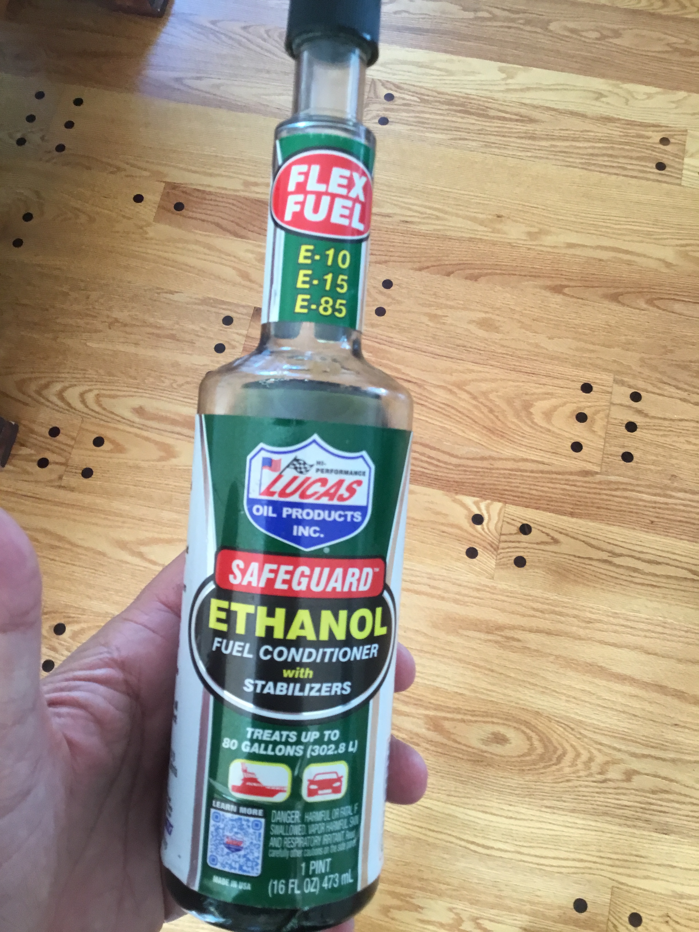

Royce, on the one that has the ethanol issues, do you add anything to the fuel to help alieviate that or are you able to get non-ethanol fuel?

If you live near a marina , alot of new boat motors dont like e85 fuel. Here along the Colorado River , almost every gas station has a non e85 pump and a race gas pump. Non e85 is about $1.00 more tha premium .
Years ago , i ran alcohol in my 64 fairlane. I used Redline alcohol fuel lube and it did a wonderful job of keeping everthing lubed and never had any growth issues either. They have a real carguy tech line and its about $16.00 a bottle…should do 3 or 4 tanks
