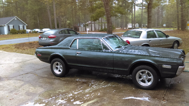

No doubt about trying to keep pace with an rt considering that the 440 magnum was standard on the rt with hemi being the only engine option. Here’s a couple of pics my '68.

Thanks. The car green centers would look nice. You’re not letting the grass grow under your feet. You’re getting busy on that car. It’s funny that most of us look at glass packs as kind of antiquated. I can still remember when they were all the rage.
