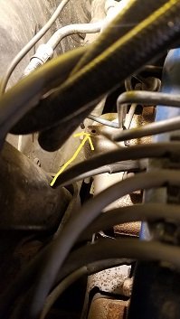

So, I bought a heat riser/choke tube kit and this is what I have going on. It doesn’t quite fit as I hoped. You guys think maybe that manifold is not correct for the 69 351w?
You have to hand bend it a bit to get it to fit. It’s a reproduction, that’s the way they are.
