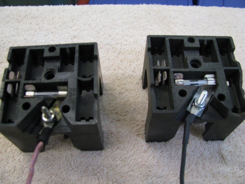

I have what I think is called an aux fuse buss. I would like to install it in/ on my 69 xr7 stock fuse box . The question is how do I do this. would send a picture of it but don’t know how. It is item 24425 in the WCCC catalog
It’s relatively easy. You’ll need a carriage bolt and a couple of nuts. Slide the buss with the one fuse clip into the diagonal with the carriage bolt loose but a nut on the shaft. Once the buss is in place, tighten the carriage bolt with the nut so that the buss doesn’t slide out. Put the wire extender with the ring connector onto the shaft and place a second nut over it, and tighten. Then install a 20 amp fuse.
The proper carriage bolt is not reproduced, or at least I haven’t found an exact match. IIRC, it is a #8 bolt.
Thanks ; I have the hardware too. I guess the hard part is I’m on my back wedged between the seat and steering wheel.
