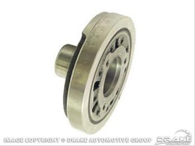

Are you sure it isn’t D2TF? If it is D2TE-6316 according to Scott Drake it will work on 1969 302s and 351Ws. See the Summit Racing link below. Note 302 = 5.0 amd 351 = 5.8
6316 is the group number used for harmonic balancers and associated parts in any year or engine size. The balancer has an engineering prefix after the year, and it has a change level designation after the group number that is also needed for identification of specific application.

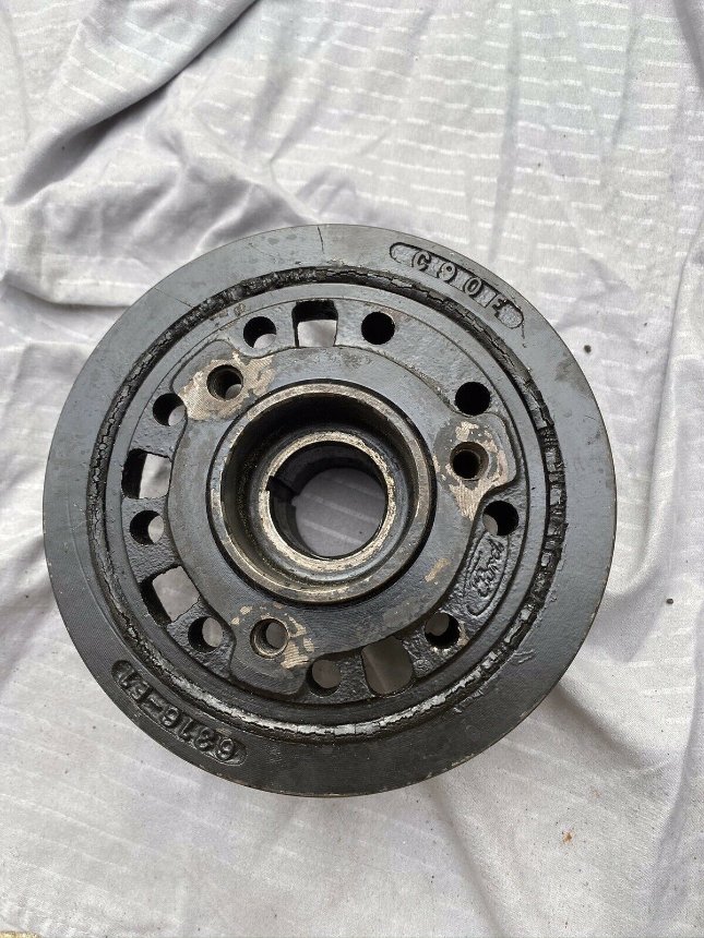

For example here is the engineering number cast into a 1969 351W balancer - C9OE 6316-E1.
Ditto on the C9OE-6876-E1 that’s what I have for a 69 Mustang 351W build date Apr, 1969.
