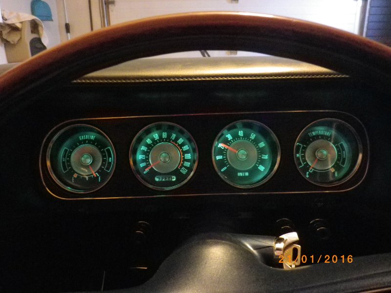

I replaced all my bulbs with Plasma LED from WCC, the tail light were fantastic , but the dash lights weren’t as bright as i thought they should be ?
Certainly 100% better than original, but didn’t go as bright as i was expecting.
WCCC DASH LEDS
Thanks for the pic. I’ve ordered a set and have to remove the cluster.
