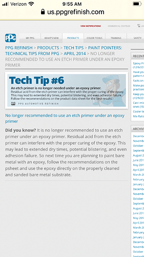

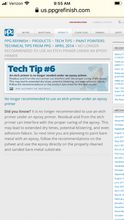

Self etching epoxy primer and you can use body filler right over top of it.
So is epoxy primer and self etching epoxy primer the same ? I purchased Ppg JP375 epoxy primer. It doesn’t say “etching”.
Want to make sure I start the right way!
Self etch and epoxy are not the same. You either use one or the other. Epoxy is the top choice because you can apply filler directly over it if you are with in the recommended top coat time. Most people have got away from self etch and use epoxy as a ground coat these days.

From the PPG Data sheet for DP74LF (all the others are identical):
"After 1 week, it must be cleaned, sanded and recleaned.
· Reapply 1 additional coat of DPLF Epoxy Primer.
· Allow 30 minutes dry time with DP402LF @ 70°F (21°C)
· Allow 60 minutes dry time with DP401LF @ 70°F (21°C) before applying additional
primer surfacers and/or topcoats.
That’s correct epoxy is good for extended storage. Then you can scuff it up and do your metal work reapply and do your filler work as you have time.
I always used self etching Vari Prime (DuPont) until it got stupid expensive. Then I switch to epoxy primer and actually like it better and have had no issues with epoxy primer. Lot of different brands on the market. https://www.semproducts.com/product/metalocktm-dtm-high-build-primer/primerI I use SEM Metallock and thin it down for my first coat so it doesn’t act like a build primer. You can use it as a build primer also, but it doesn’t sand as easy as a regular high build primer. Epoxy is the way better option for long storage time between body work and paint. Etching prime will not protect it from flash rust long term. It’s basically a go between the metal and build prime to give it adhesion to each other.
