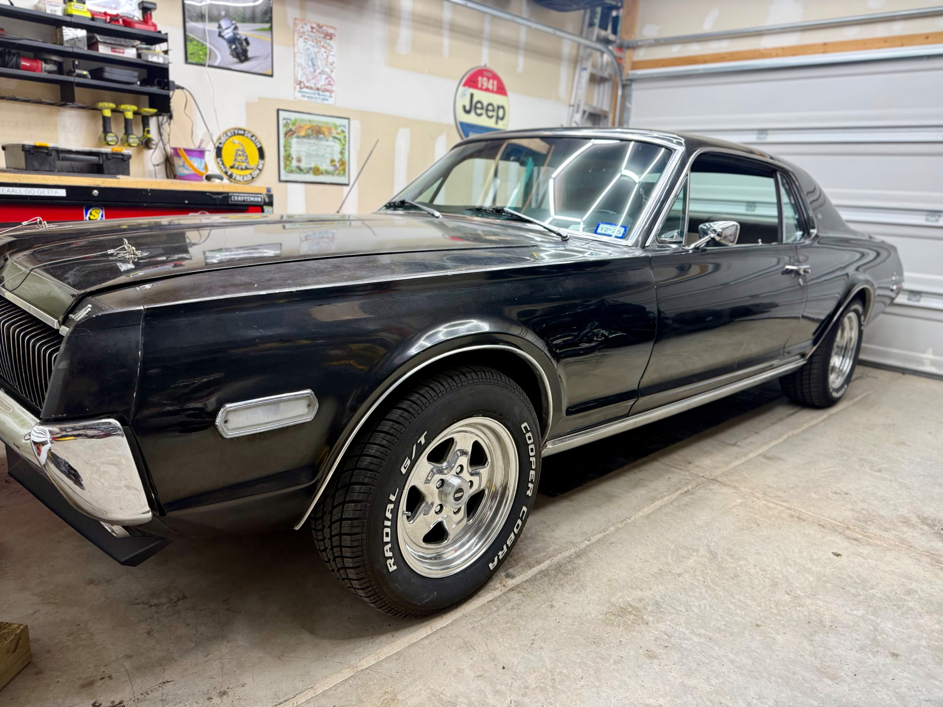

I’ve got a 1968 XR7 that I recently replaced the entire real suspension on (shocks, leafs, shackles, hardware, and rubber components) because the rear tires were rubbing when anyone was in the rear. I’m trying to figure out if it’s better for me to change wheels so the offset in the rear tucks them in more (don’t want to go thinner than an 7” with 235 tires) or somehow raise the rear up. All opinions and help are appreciated. TIA.

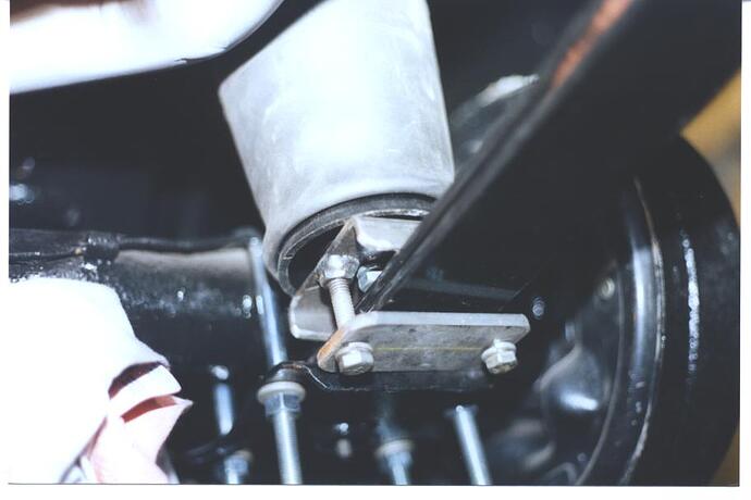

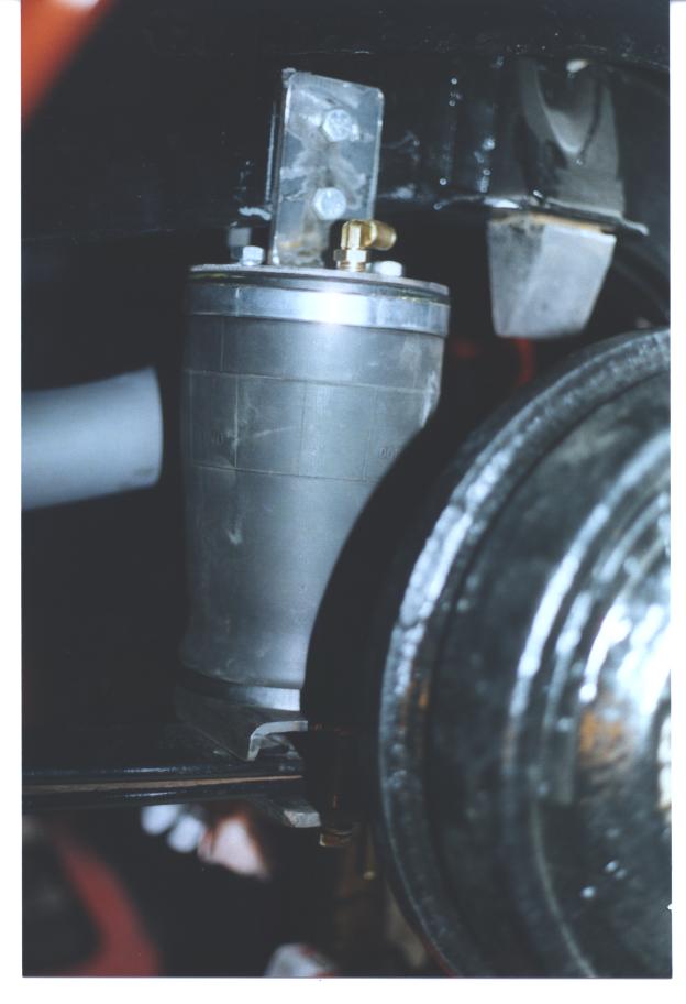

And I know all about the airbag set-ups. I have them on two of my cars, Cougar included, and helped install them on three other cars in addition to my two.

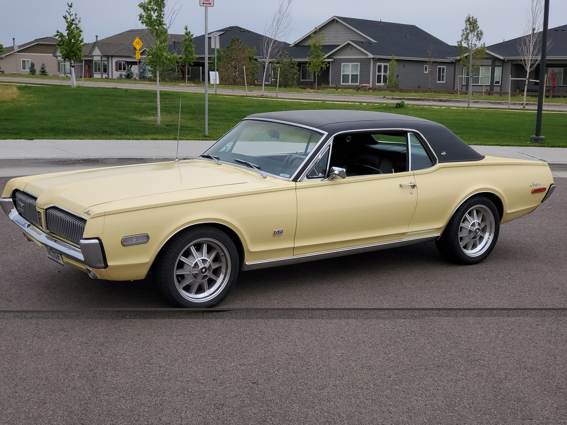

On my previous Cougar, I had 17x7 and 17x8 Legendary 10 spokes…the rears had 4.75” backspacing with 245s and I didn’t have any issue with rubbing.

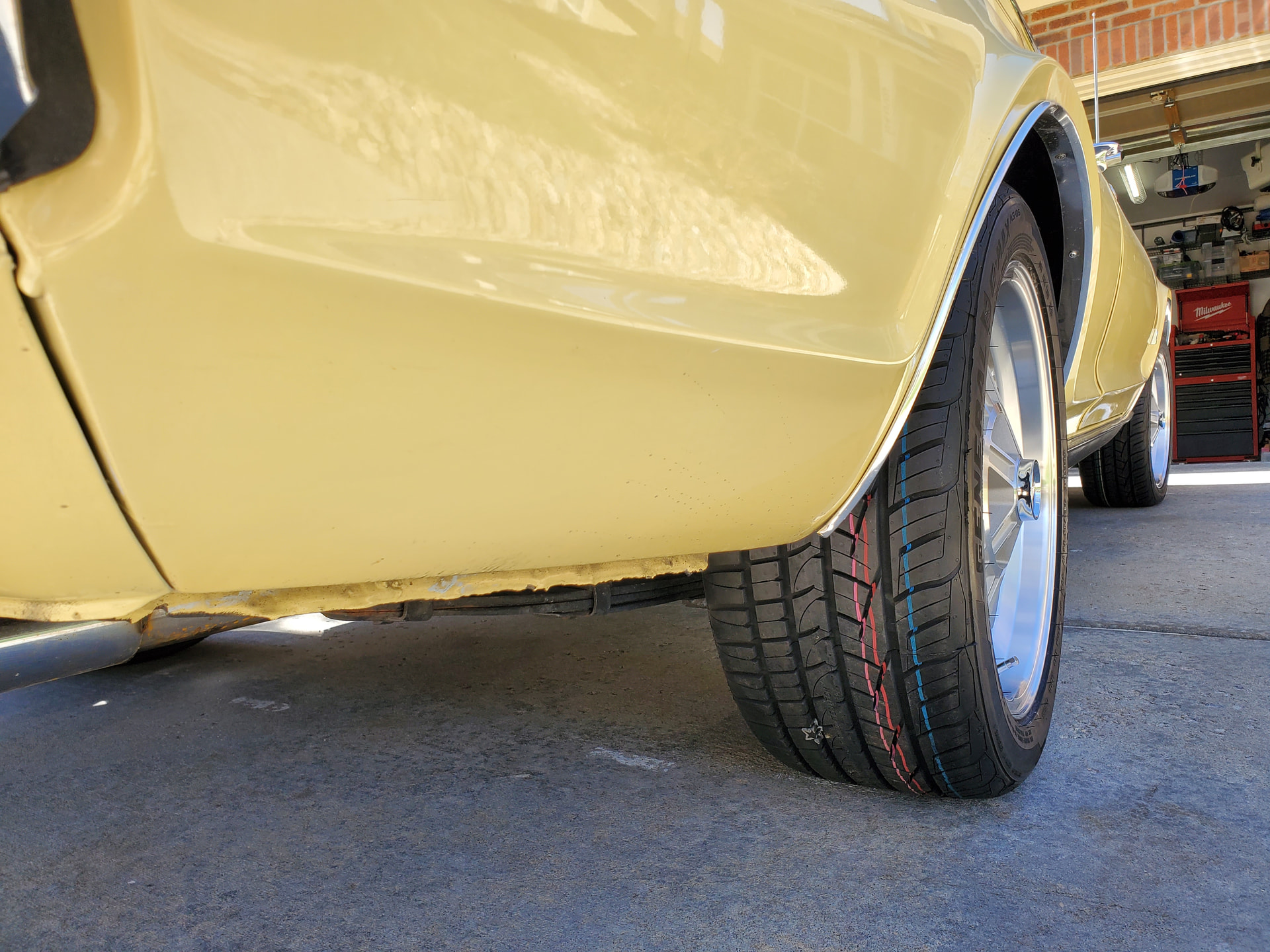

American Racing TT2’s 17x8 ET8.
4.81 backspace according the specs.
245/45 tires. Haven’t noticed any contact or rub anywhere.

Might just be the angle, but in your photo it doesn’t look like the rear tires stick out. If anything it seems like the front tires could use some backspacing to tuck them in more.
