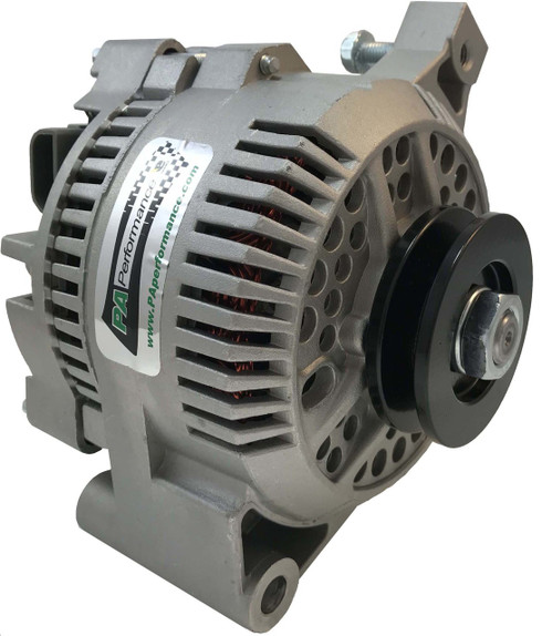

There are cheaper ways for this change, but here is one option as it’s more of a plug and play and eliminates need to hack the existing wiring. From my understanding, this smaller case fits better than the larger / higher amperage 3G alternators.
