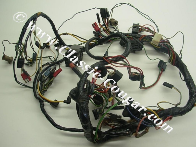

If you look on the right hand side, about midway down from the top, of this photo of a 67 XR7 under dash harness from WCCC you can see the same type of connector, but it’s got green and yellow wires to it. So the connector is at least stock. It’s just from another portion of a harness.
In fact, I believe you can see that exact connector and wire combo under the “g” in “Cougar.”

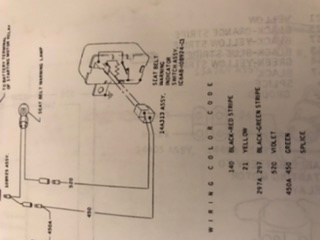

Looking at the wiring schematic and the wires under my dash. It doesn’t look like it’s anything to do with the tilt column.

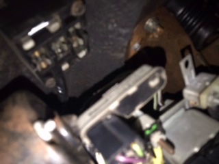

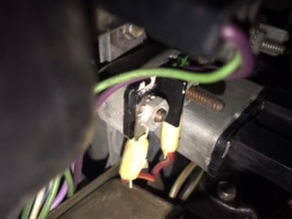

The only wire I see that color is plugged into my seatbelt warning buzzer which mounts at the bottom of the fuse panel. My plug has violet and green together and in the wiring schematic it shows that violate and green #520,450. I guess I don’t know why yours has violet and black but it’s something to look at anyways. Pictures aren’t real good but you can see the plug in the picture. I was snapping them blind with my phone camera.
I appreicate everyone trying to help here, I am glad the harness picture showed it!! Now Just what does it got to???

https://secure.cougarpartscatalog.com/store/p/13345-Wiring-Pigtail-Under-Dash-Harness-to-Ignition-Switch-Used-1967-Mercury-Cougar.html?attribs=75
Try this plug. It looks like it might be the same.
The plug that is in the harness picture goes to the side of the ignition switch and is part of the brake warning light. Most of the harness’s are two violet wires but I have had some with the violet and black wire.
