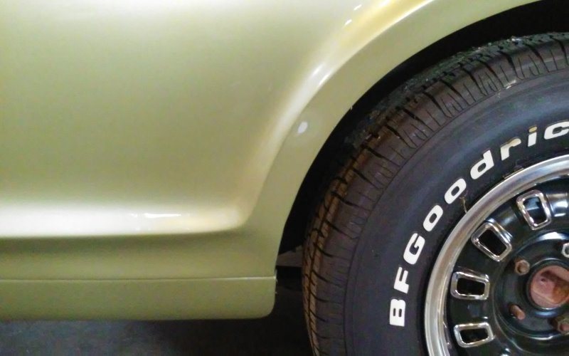

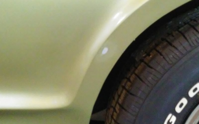

Still don’t know what I am going to do. Here is the spot. The pics don’t show the scratch. Just show that I was stupid enough to think I could wet sand and make it look less noticeable :blush:
If you can tape to a sharp body line then blend clear to that line. you can leave the sharp edge and wet sand it out on the body line so it isn’t that noticeable. When you’re blending out to a flat panel the clear you’re spraying becomes to thin and will have a hazy look to it. Sometime you can wet sand the clear back so it blends good and sometimes you can’t :unamused: That’s the part that takes some experience to master. Unfortunately I’m not quite at that level yet.
If you’re not pass that body line on yours around the arch (think of where the GTE molding would mount) I would spot color it and clear to that body line and then wet sand the parting line. One advantage it’s lower on the car and less noticeable.
pellets4fuel: Yes, our clear coat break being transitioned on the hood nose bodyline was probably a plus. And, would follow along with Brian C’s previous comments & suggestions. Looks like you have a nice break point at the bodyline around the rear quarter wheel opening. So, your repair area shouldn’t be too noticeable when complete. Also, You, being the Cats owner, will notice subtle after-the-repair flaws that others won’t see. :slight_smile:
