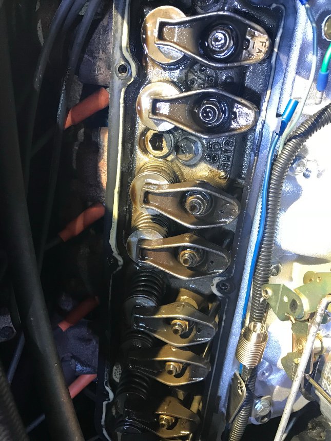

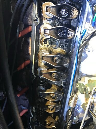

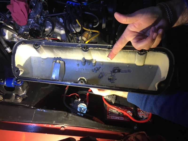

This is what the inside of my valve covers look like.
Yup. Blown head gasket.

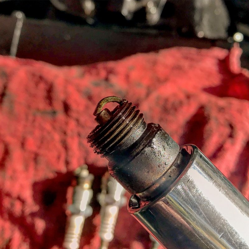

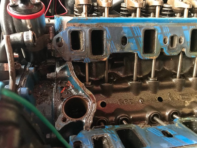

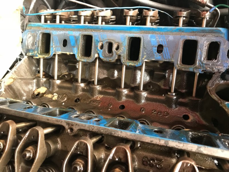

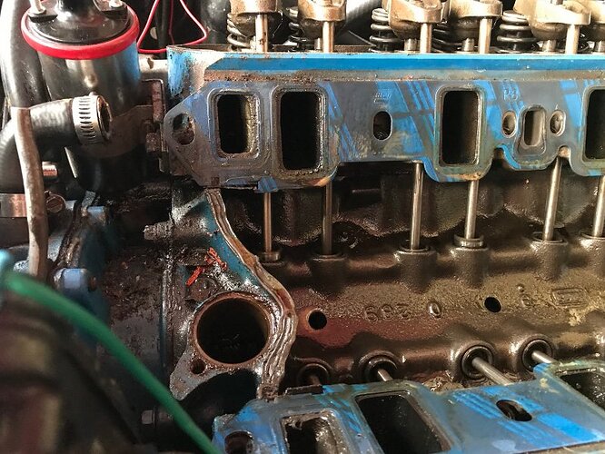

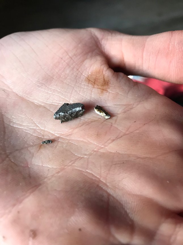

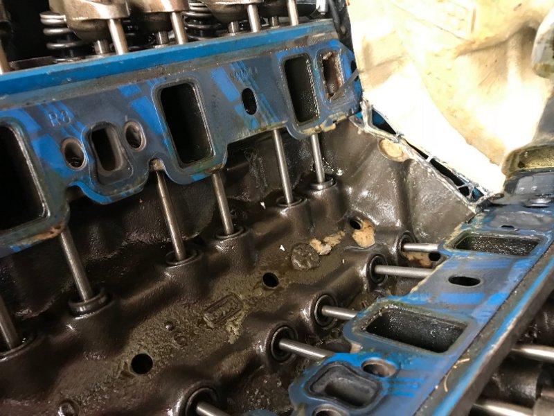

We found shrapnel inside (under the intake manifold). One of the spark plugs was smooshed down too.
Looking at new engines now. Ugh.
On the lifter galley? Wow! Do you have a picture?
