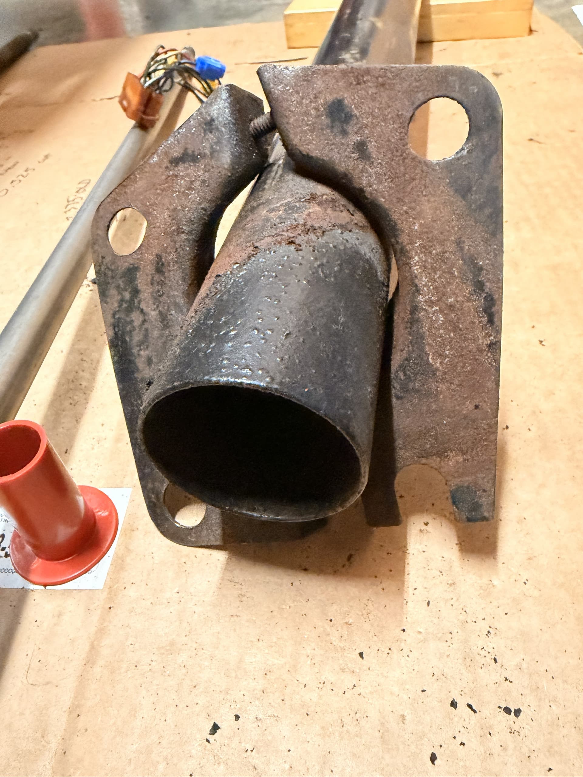

Sure! Here’s the steering box side of the stock column and mount (yes, I still need to clean and paint it).

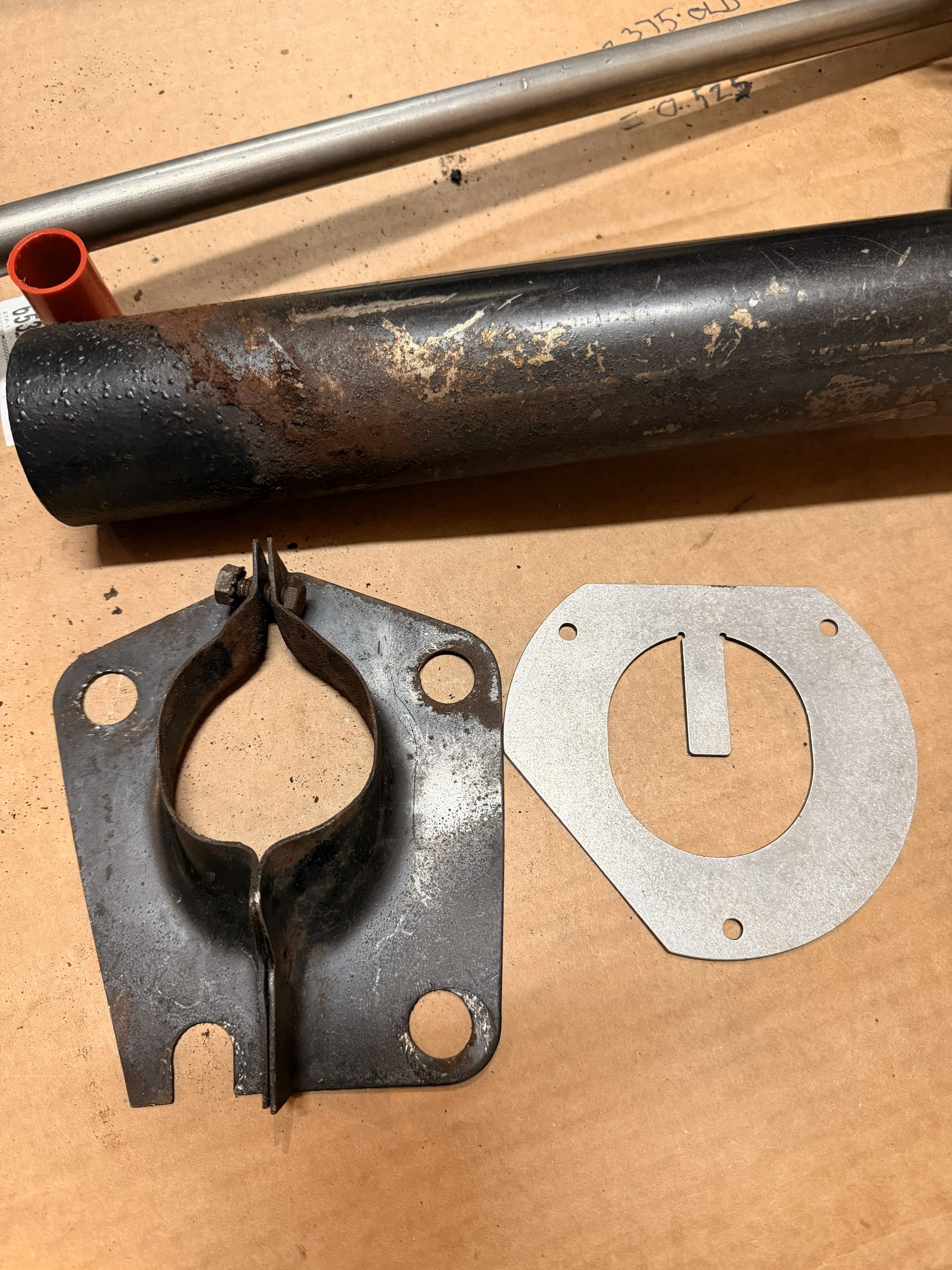

Step 3 of the instructions say to install the column mount from the kit to the firewall/floor with the 2 tabs bent inward (there’s really only one tab on the mount). A standard hose clamp is provided to secure the column to the mount by clamping around the tab.
As you can see, the hole pattern is completely different (the two top holes don’t even line up) and the stock mount won’t fit on top of the kit’s mount with the tab bent inward and the clamp in place. I can’t image that the kit’s mount would secure the column better than the stock mount and I’m inclined to leave it out. Seeking opinions from people who have dealt with this before and wondering if there’s something I’m not considering (like maybe the column angle ends up being slightly different). Thanks.
Use your stock mount. It works much better.
