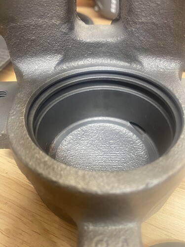

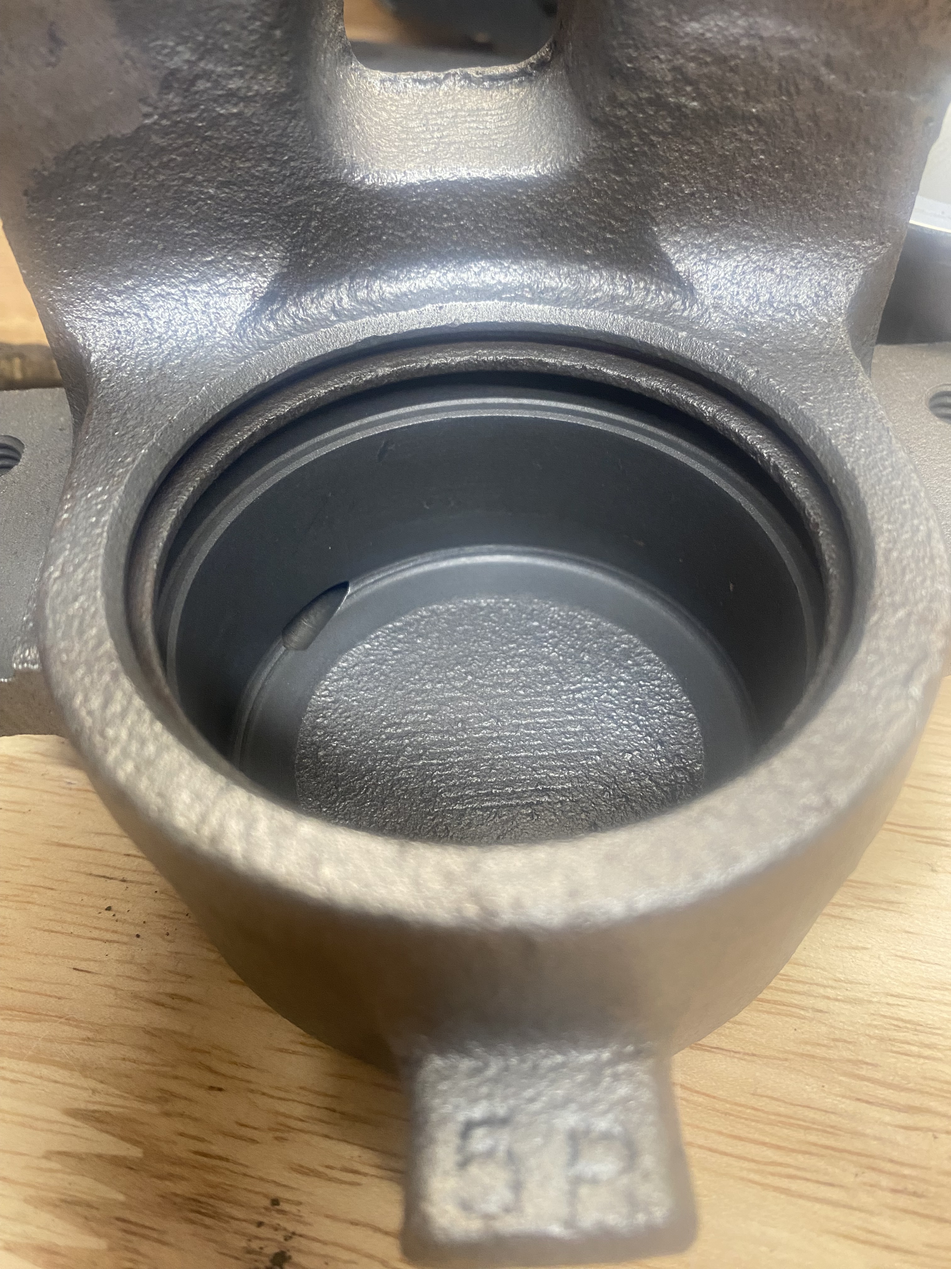

I’m rebuilding the brake system on my ‘68. Power discs in front. I have all new seals and pistons. After cleaning up the calipers I notice that the area around the outer rubber seal is pretty pitted. The bore and surface around the piston O ring looks fine. My question is whether you think the outer seal will seat ok as is or if I need to replace the caliper. I’ve posted pics of both. The other is in much better condition.
Thanks in advance for any feedback.
Andy McCulla - Portland, OR
If you’re referring to what appears to be pitting on the 90 degree (?) edge of the seal in the top picture only, I would not be worrying about it. It may help if you to some overlays with arrows or something like that to highlight what you’re referring to.

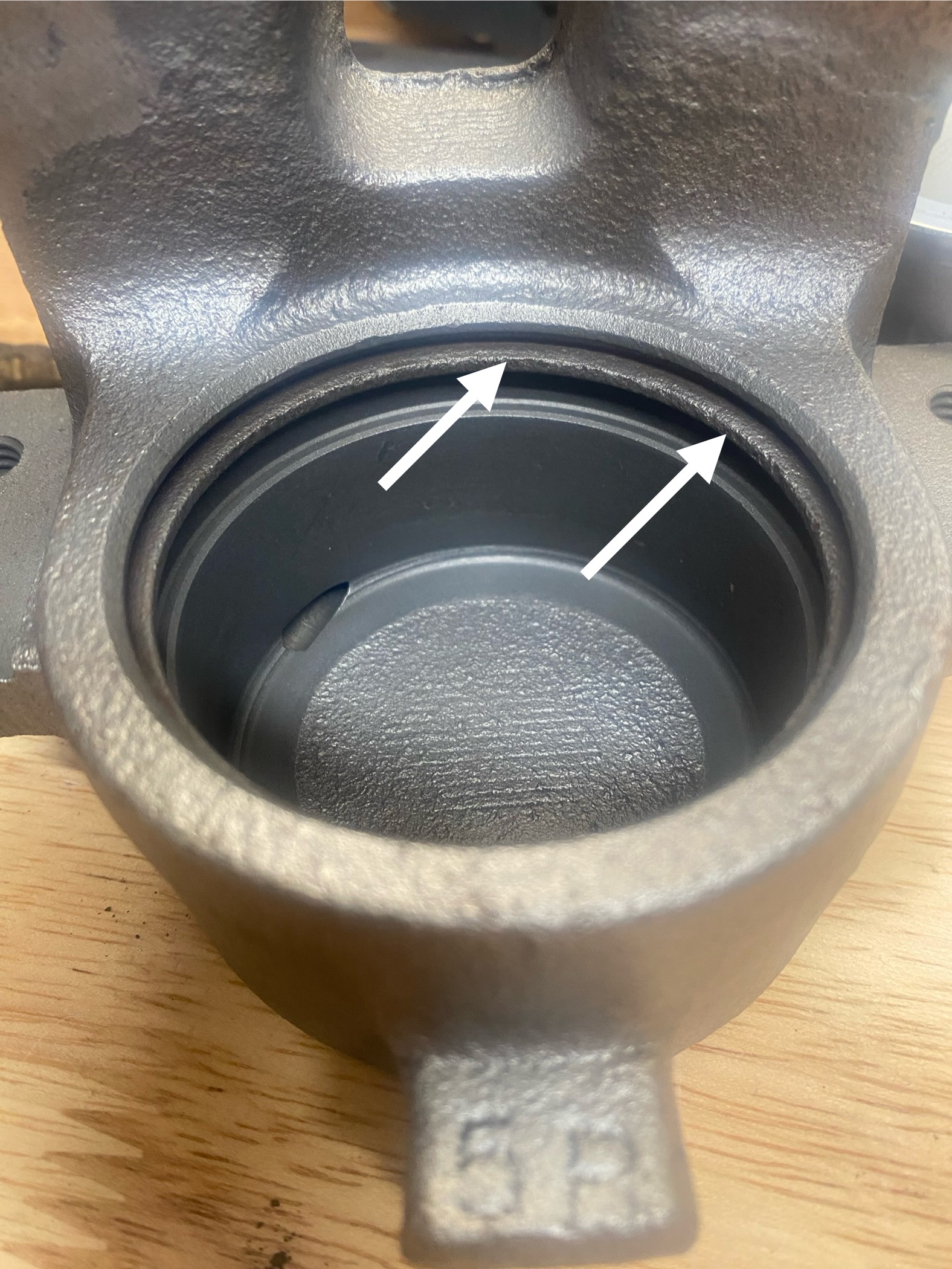

Thanks for your reply and recommendations on the photos. I’ll add some pointer arrows tonight. The edge face I’m concerned about is actually the next one below the top edge. It may not be pitting … maybe just as cast (?) … but the other caliper (second pic) has nice crisp edges and surfaces.
Check back again for updated photos.
Andy
Hope this helps to clarify the area I’m asking about. Thanks !
I wouldn’t considered those to be a problem at all. The piston to hard rubber o-ring is the more critical seal point. The outer seal stops dust and debris. Be sure the bleeder threads and seat are clean.
