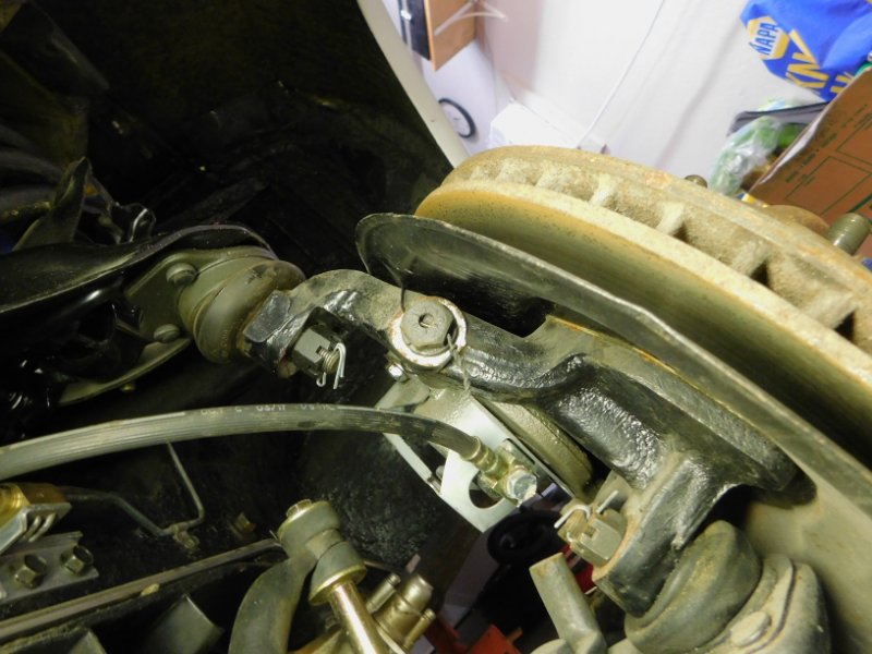

The factory did a rudimentary job using plain iron wire. This is approximately as the factory did it. You can improve it by using .041" stainless aircraft wire of course.
