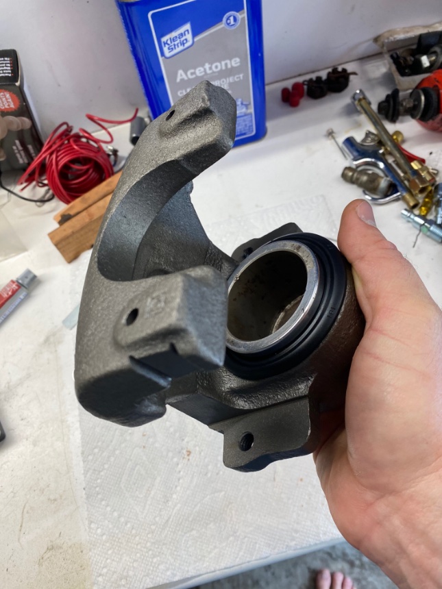

I thought I would update this post with my rebuild results. I haven’t found any walk-throughs of this process on the forum (maybe it’s considered too basic for most competent mechanics) so I thought I would walk through how it went for me.
First, I removed the caliper bracket and caliper from the spindle (it’s much easier to get leverage on the two heavy bolts while the spindle is still on the car).
Then I removed the guide plate and the brake pads so the caliper and the caliper bracket were separated.
Next I placed a small wood block in the caliper, opposite the piston, and used compressed air into the hose inlet to press out the piston (make sure the bleeder screw is shut). I just pressed the rubber tip of my air gun against the inlet hole and that held enough pressure to get the job done. When it releases it comes out pretty hard so don’t try to catch it with your hand!
I removed the dust seal and the inner rubber seal from the caliper. The dust seal comes off with your fingers, you’ll need to use a small screwdriver or something to remove the inner seal from its groove.
After degreasing the caliper, I soaked it in evapo-rust and examined the bore. Nice and smooth so it’s good to rebuild.
The piston was also in great shape (with a tiny FoMoCo logo still on the back face) so I cleaned it up for reuse as well.
I masked off the bore and painted the caliper with Dupli-color engine enamel “cast iron” color. I don’t know what’s the best to use if your detailing but this looks okay to me.
Then it was time to reassemble the seals, piston, and caliper.
First I used a thin amount of lithium brake part lube to coat the inner seal, then I installed it into the groove in the caliper bore.
Then I installed the dust seal and worked the lip of the seal all the way around the piston, kinda like putting an inner tube on a bike. Finally I used two blocks of wood and a pistol grip clamp to press the piston back into the caliper.
And that was it. It was a lot simpler than I thought it would be and a very satisfying little project. The seals were only $5 at the local auto parts store and all it cost me above that was a little bit of paint and evapo-rust.

I just rebuilt mine too, media blasted to clean 50 years of mother natures abuse. Re coated/plated for the “natural” cast iron look and new seals. I think they look pretty good. Impervious to brake cleaner/carb cleaner too. The second picture is a before and after.
That finish looks great! How did you get that look?
I used gun bluing fluid, then steel wool to lighten it up and achieve that look. I sprayed it with the harshest chemicals I had and it didn’t seem to bother it!
