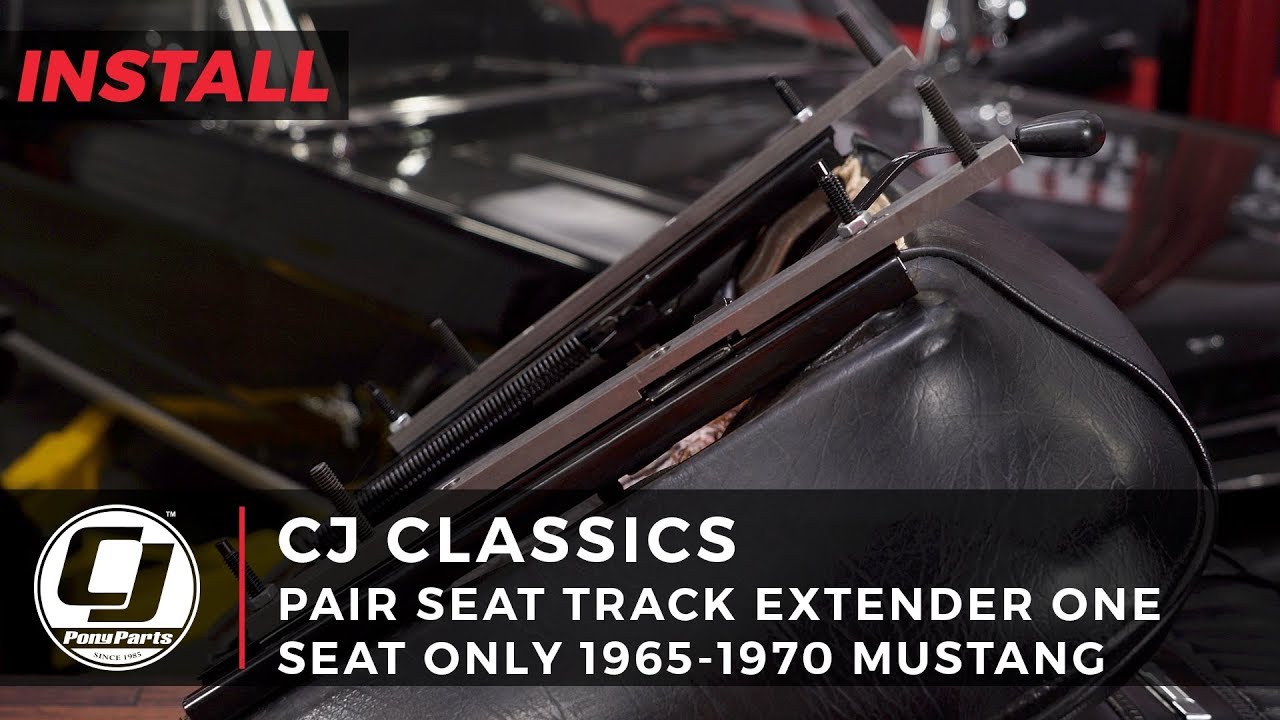

I’m getting pretty sick of having to kick my brake pedal after every stop, just to get my brake lights to go off. I went ahead and ordered the seat extensions too. Hope I have a good report for you next week!
Edit: Found this vid at cjpony that demonstrates the install…

So I got the Scott Drake from WCCC, but I didn’t get the bushing kit. Once I got that, it was all good. While I was at it, I did the seat extensions, which is a must for al big/tall dudes. The front threaded bolts threaded up instead of down, so I gotta go back and fix that…but otherwise, mission accomplished!
