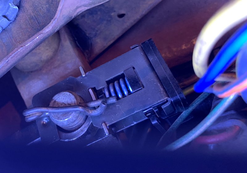

Just to be sure…
Is THIS what you guys are talking about?
The thing connected to the plunger?
Yep that’s the right switch

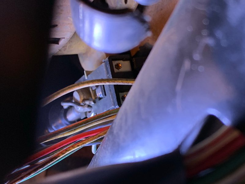

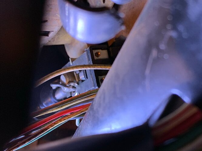

All you need to do to remove the switch is to pull that pin shown in your photo. Then the switch and the rod to the master cylinder will slid off the brake pedal. It is a bit hard to see but from your photos it appears that you are missing the plastic bushings that fit over the stud on the brake pedal. If the bushings are missing the switch will be a little loose on the stud and can move forward and backward a little. I do not know that it would have enough movement to cause your problem though.
My son took the pin off… but couldn’t get the clearance to slide it off the brake pedal.
Any tricks I can give him?
You only need to slide the switch sideways a wee bit, then tilt it upward. The inside “hole” is actually a slot.
The whole rod rotates to get the switch and rod off the pin. The whole rod has to come off the pin, then you can remove the switch. You should get the plastic bushing if it is missing. Without it the brake lights will come on very late, if at all. Great way to get rear ended by another car and it will be your fault, not theirs if your brake lights are not functioning.
