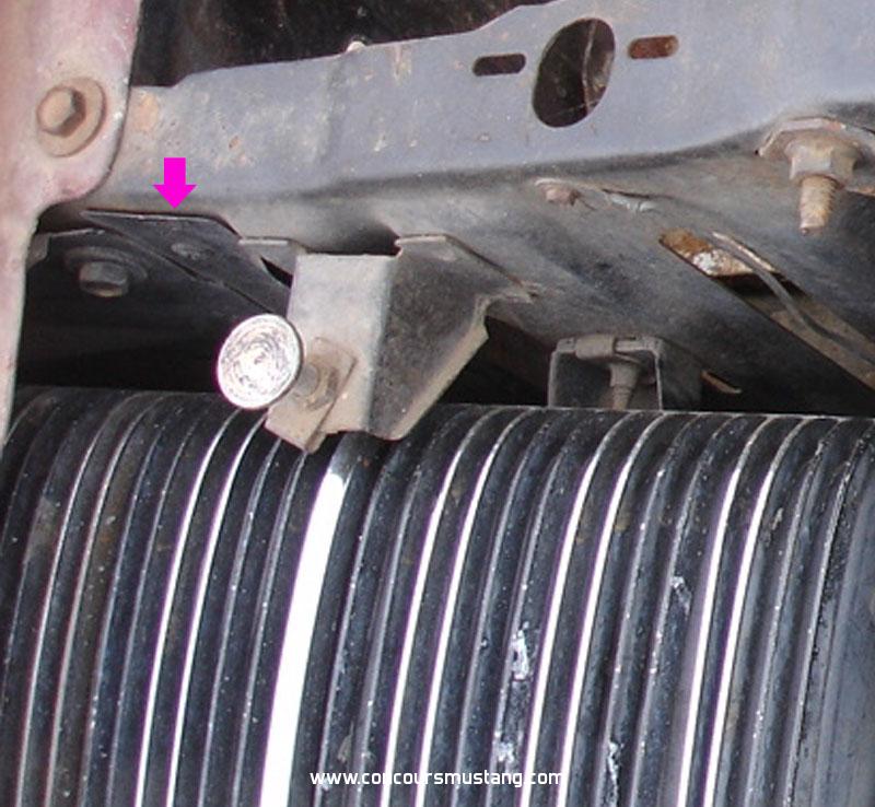

The buck tag is located on the radiator core support on the upper right side next to where the painted fender support overlaps the core support.
Thanks guys, mine doesn’t have a hole there but one on the right hand side instead.
Should the hole be where that dint is on the left?
[attachment=0]buck2.jpg3.jpg[/attachment
Brett, based on the “before” pic you posted, I believe the hole for your buck tag is behind where the fender overlaps the radiator support. In your old pic you can see what looks like a U-clip for the fender bolt, maybe? Fairly common for them to be partially covered by the fender overlap. Here you can see mine has the bolt and fender in place, with the tag screw over a smidge further than yours.
I hope that helps!
Thanks Mike, All good mate I put it where it should be now.
