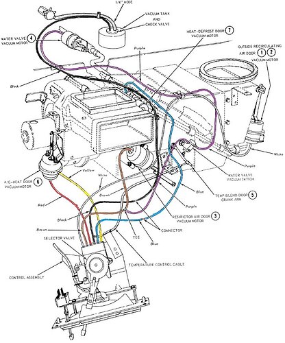

I got my A/C working correctly this weekend. Somewhere in the process of re-assembling my Dash the “Blue” Vacuum line came off the Vacuum motor.
My wife wouldn’t ride in the car till I got the A/C working. I was lucky that I found the Vacuum hose dangling when I let the glove compartment door down to inspect in there. I only had to pull the radio to get up in there to reconnect the hose. “WHEW” I had visions of pulling the dash pad again and was NOT looking forward to it.
