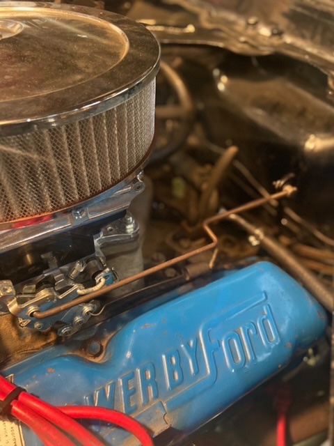

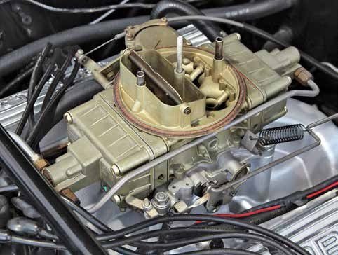

Pursuant to Royce’s point, I thought I’d post where I have my own similar combination connected on the carburetor bellcrank. The linkage on our '68 302 cars is readily traceable and adjustable while on your back under the car (on jackstands). I’ve got full throttle (primaries vertical) and the kickdown working.

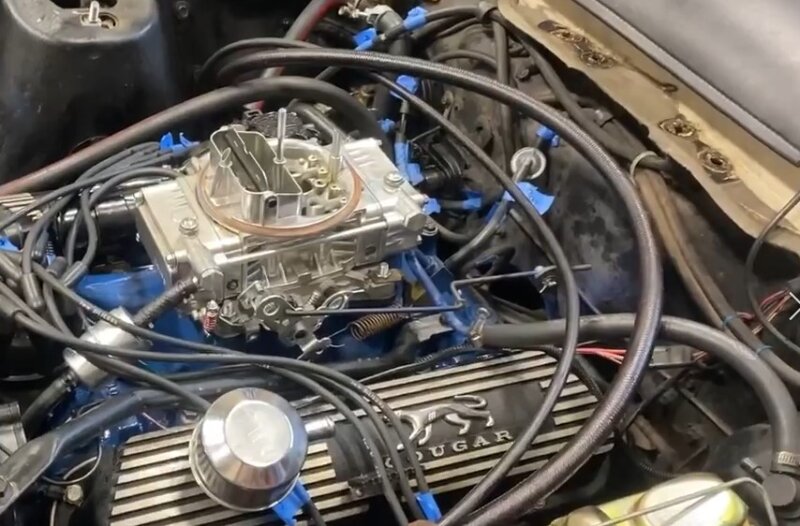

I’ve been fighting with trying to get the kickdown to engage. There’s too much slack in the cable/assembly(no more adjustments) and I can’t get anymore throw from the accelerator shaft. I took my linkages to a local mustang guru and he’s saying that the accelerator shaft is likely bent. I tried removing that whole assembly but I can’t get the pedal off even with the help of liquid wrench.

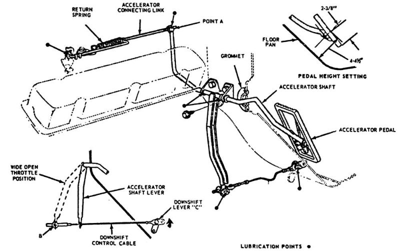

So, just something to think about- But the gas pedal is supposed to be about 3 inches from the floor. That distance will affect the adjustment of the accelerator linkage rod. The picture shows it is bent ‘out’ away from the carb. You don’t have the right throttle return spring on the carb. I’m not trying to be nit picky, just that these short measurements can add up to a lot of linear distance. Also, what is the length of the cable from the trans to the connecting point on the bottom of the accelerator gas pedal? My understanding is that is should only be like 12 3/4 inch. I have read of many other people having a wide range of length, usually too long to work effectively.
