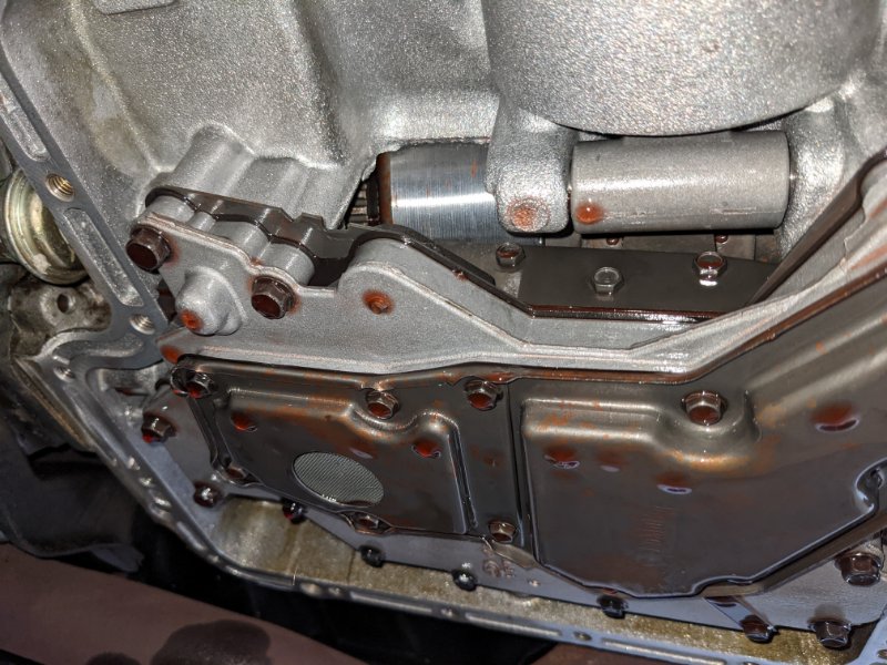

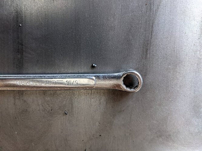

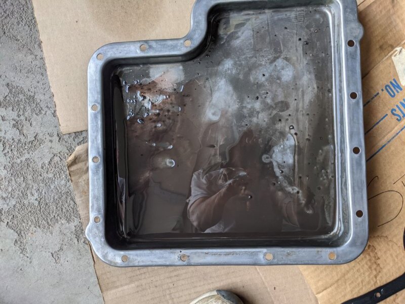

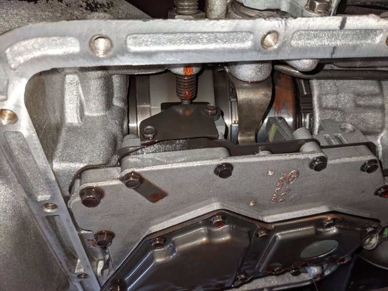

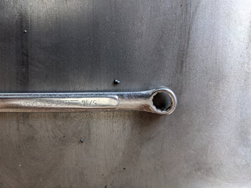

I then drained the transmission fluid and got about 2 quarts from the pan and another 6 from the torque converter (didn’t drain the converter completely as I ran out of drain pan :smiley: ). Seems a bit low. I noticed a bit of sludge in the bottom of the pan and while cleaning it up noticed some “chunks”. I took pictures and have attached. The fluid was clear for the most part except in the bottom of the pan and completely clear coming out of the converter. It seemed like it flowed normal was not syrup like.
Seems to me that i may have been low on fluid as Royce mentioned. I’m still open to other ideas. My current plan is to pick up a new pan gasket in the morning and refill with fresh fluid. Thoughts or ideas?

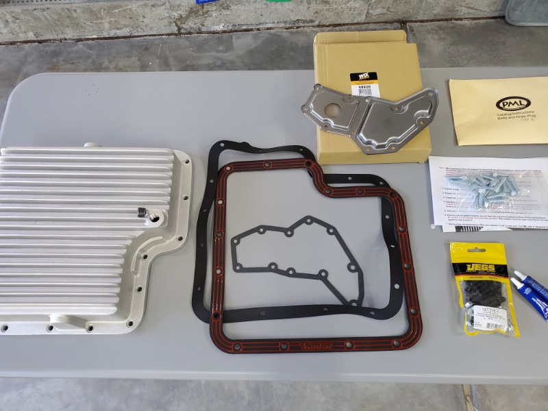

I just swapped out the fluid/filter/pan on my C6…the “filter” only seems to capture big chunks. I replaced the pan with a low profile aluminum one with a drain plug which makes it much easier to drain fluid, although a drain plug could be installed in stock pan.
That looks like a nice pan and I bet it’s not as susceptible to leaking. I’d love to go that route, but I’m trying to stay stock.
I wasn’t worried in keeping pan stock, but didn’t want a deep pan that would look odd. I kept the original pan though.
I would check/ re-set your bands. Might explain the slippping. Steps are in the service manual.
The screen mesh filters can be cleaned. They are not meant to capture the old friction material which is what you see in the pan. You did good. The material in your pan is 1/10 as bad as I have seen with a perfectly good transmission.
These things (C6 + converter + cooler + lines) hold something like 12 quarts of fluid if dry. They are notorious for having a crack in the dipstick tube behind the O - ring which makes it appear you have a leaky pan gasket.
